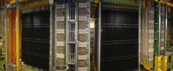

The Oscillation Project with Emulsion-tRacking Apparatus (OPERA) is an experiment to test the phenomenon of neutrino oscillations. It exploits CERN Neutrinos to Gran Sasso (CNGS), a high-intensity and high-energy beam of muon neutrinos produced at the CERN Super Proton Synchrotron in Geneva, Switzerland, and pointing to the Laboratori Nazionali del Gran Sasso (LNGS) underground laboratory, 455 miles (730 kilometers) away at Gran Sasso in central Italy.
The OPERA experiment, which observes a neutrino beam from CERN in Geneva, Switzerland, to Italy’s INFN Gran Sasso Laboratory 450 miles (730 kilometers) away, presented new results indicating an anomaly in the speed of subatomic neutrinos.
The OPERA result is based on the observation of over 15,000 neutrino events measured at Gran Sasso, and appears to indicate that the neutrinos travel at a velocity 20 parts per million above the speed of light, nature’s cosmic speed limit. Given the potential far-reaching consequences of such a result, independent measurements are needed before the effect can either be refuted or firmly established. This is why the OPERA collaboration has decided to open the result to broader scrutiny.
