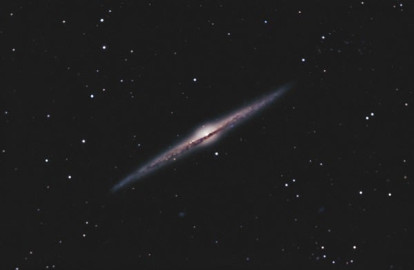

NGC 4565 is a bright, almost perfectly edge-on galaxy in Coma Berenices. Its central bulge occupies about one-sixth the diameter of its disk, so it is a Hubble class Sb.

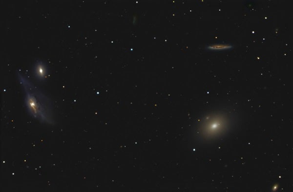

The sky contains many galaxies with diverse shapes, such as those in this portion of Markarian’s Chain in Virgo. M86, the large elliptical galaxy at lower right, is Hubble class E3 because it is slightly elongated rather than spherical. Also shown are NGC 4438 and NGC 4435, “The Eyes,” on the left side of the image, and NGC 4402, at upper right.

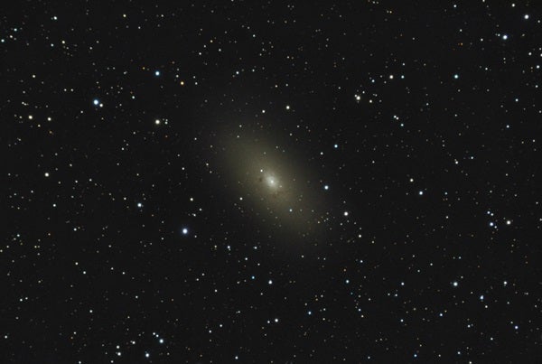

NGC 205, one of the two bright satellite galaxies of the Andromeda Galaxy (M31), is twice as long as it is wide, earning it a Hubble class E5.

The central, dominant galaxy in the Virgo Cluster is M87, a giant E0 galaxy. It’s easy to see this galaxy as perfectly round. As a challenge, look slightly to the west at M86. Even a small scope will show it definitely is not perfectly round. The mild eccentricity of this galaxy, which is featureless even through large apertures, earns it a classification of E3.
One of the satellite galaxies of the Andromeda Galaxy (M31), NGC 205, is a large bright E5. It is so elliptical that it is twice as long as it is wide, measuring 10′ by 5′. Visually, it brightens gradually toward a much brighter center, and larger scopes show a non-stellar nucleus.

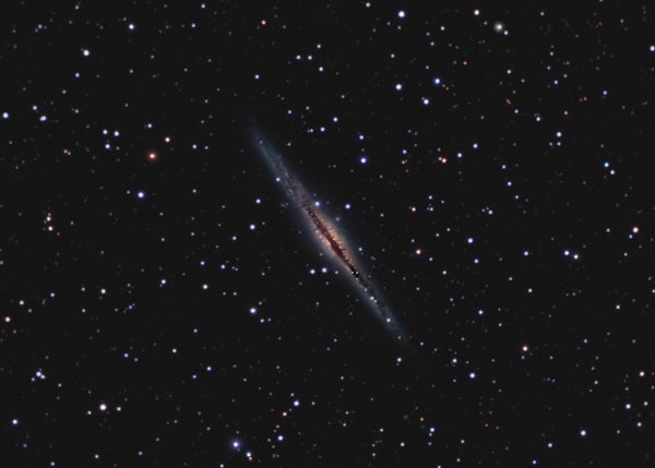

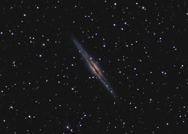

NGC 891 is an edge-on class Sb galaxy in Andromeda with a central bulge occupying about one-third the diameter of its disk. It lies near the plane of the Milky Way’s disk of dust, which scatters much of its light. That, and the lack of a nucleus that is obscured by its equatorial dust lane, contribute to its faintness through telescopes.

The sky offers two splendid, but contrasting, edge-on Sb galaxies. NGC 891 lies 3.5° east of the beautiful double star Almach (Gamma [γ] Andromedae). Through small scopes it appears as a faint discus of light measuring 15′ by 3.8′ floating in a sea of foreground stars that provides a stunning 3-D effect. The central bulge occupies one-third the diameter of the disk and tapers gradually toward the tips. NGC 891 has no visible nucleus because it is obscured by its perfectly centered dust lane. An 8-inch scope and dark skies are required to spot the subtle but fairly wide dust lane against the slightly brighter central bulge. Larger apertures will show the dust lane extending farther into the disk on either side.

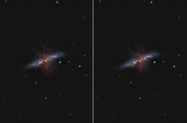

The Cigar Galaxy (M82) is an irregular galaxy, not fitting the criteria for elliptical or spiral galaxies. It is considered a starburst galaxy heavily disrupted by star formation and frequent supernovae, probably triggered by a recent merger. The most recent supernova was SN 2014J, which appeared in January 2014 in the photo on the right, but was not visible in the photo on the left, taken a few months earlier. The supernova was reddish due to scattering of light by the galaxy’s dust.
NGC 891 appears faint mainly because it lies close to the Milky Way’s equatorial plane. That means our galaxy’s disk of dust blocks and scatters a considerable amount of its light. By contrast, the Sb galaxy NGC 4565 marks the Milky Way’s North Galactic Pole, just as Polaris marks the North Celestial Pole. We view it perpendicular to the dust plane, providing a view virtually unimpeded by dust. So, even though the galaxies are similar in size and lie at roughly the same distance, NGC 4565 appears twice as bright.
NGC 4565 lies 1.5° due east of the star 17 Comae Berenices and measures a large 20′ by 3.6′. Through the telescope, it is a beautiful sight, appearing as a long, thin sword of light with a central bulge occupying only one-sixth the diameter of the disk. It resembles a flying saucer in science-fiction movies or two fried eggs placed back to back. Even medium-sized telescopes reveal the dark dust lane dividing the central bulge almost equally. A bright stellar nucleus beams out from the north side of the dust lane.
NGC 5907 is a splendid example of an edge-on Sc galaxy. The combination of its tiny, inconspicuous central bulge and a disk that is flatter than NGC 4565’s makes it look like a mere splinter of light and hence its nickname, the Needle Galaxy. Through the telescope, you’ll see a galaxy that is amazingly nine times longer than it is wide, measuring 12.7′ by 1.4′. Scopes 8 inches and larger show an elongated nucleus and subtle mottling from equatorial dust lanes.

M82 is emblematic of an irregular galaxy. Its nickname, the Cigar Galaxy, suggests an E7 elliptical, but this object is rich in dust clouds and bright areas of star formation. It also appears discoid, but it lacks defined spiral arms. M82 is a system in a burst of star formation, probably as a result of a galaxy merger. Numerous supernovae, the most recent of which was visible through amateur scopes in early 2014, have created superheated winds of plasma that flow out perpendicular to its long axis on either side. A 6-inch scope shows a cigar of light with a wedge-shaped, dark dust cloud intruding from the south side. Larger scopes show three more dark lanes toward the east end, mottling on the west side, and bright knots near the center.
