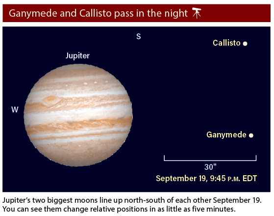

Jupiter’s four bright moons all orbit in the planet’s equatorial plane, so they usually line up. But this symmetry breaks down once in a while. Watch the evening of September 19, and you’ll see Ganymede pass 30″ due north of Callisto.

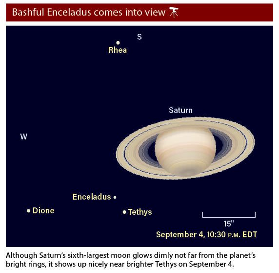

Viewing Saturn through a telescope is always a thrill. Only a handful of celestial objects look like their photographs, and Saturn ranks at the top. In mid-September, the planet’s disk measures 17″ across while the rings span 39″ and tilt 25° to our line of sight. Because Saturn reached opposition in July, its shadow now hides the far side of the rings just east of the planet’s disk. The effect gives the world a dramatic 3D appearance.
The large tilt of the rings provides exquisite views of their structure. Any scope shows the outer A ring, the brighter B ring, and the dark Cassini Division that separates the two. The ghostly C ring lies closest to Saturn and appears through larger instruments under good viewing conditions.
Amateur telescopes also reveal six saturnian moons. The brightest, 8th-magnitude Titan, shows up through any scope. It takes 16 days to complete an orbit; you can find it due south of Saturn on September 7 and 23 and due north of the planet September 16.
Three 10th-magnitude moons — Tethys, Dione, and Rhea — orbit closer to Saturn than Titan and appear through 4-inch and larger scopes. You’ll need a bigger instrument to see 12th-magnitude Enceladus. This satellite orbits so close to the rings’ outer edge that it is often lost in the glare. Look for it September 4 when it lies 5″ southwest of Tethys.
Iapetus brightens and fades as it orbits Saturn because it has one bright and one dark hemisphere that turn toward Earth in phase with its orbit. It glows at 11th magnitude when it passes 1.4′ south of Saturn on September 11. It brightens as it heads west in the following weeks, reaching 10th magnitude when it lies 8.5′ from the planet at the end of the month.

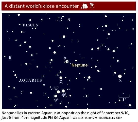

You won’t find a better time to track down Neptune. The ice giant planet reaches opposition the night of September 9/10, when it lies closest to Earth and remains visible all night. Even better, it passes within 1′ of magnitude 4.2 Phi (ϕ) Aquarii this month, so finding the right field is a snap.
You’ll need binoculars or a telescope to capture the fainter glow of magnitude 7.8 Neptune. First, locate Phi in eastern Aquarius. The star appears 30° high in the southeast by 11 p.m. local daylight time on the 1st and reaches a similar altitude by 9 p.m. at month’s end.
Once you have Phi in focus, Neptune will be in the same low-power field. The planet lies 7′ east of the star September 1, but the gap closes with each passing night. At 11 p.m. EDT on the 5th, Neptune stands 42″ east of Phi, and the separation narrows by about 4″ with each passing hour. They come closest — 13″ apart — shortly after daybreak on the 6th. The two make a lovely contrast all night, with Phi a ruddy point of light and blue-gray Neptune showing a 2.4″-diameter disk.
Neptune’s westward motion carries it 6′ west of Phi at opposition and 40′ away by the end of September. Still, the two appear within the same low-power field.

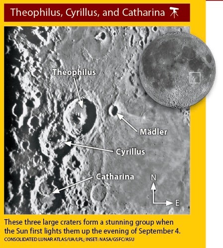

Let’s focus on the scene the evening of September 4. If you look just south of the lunar equator, three magnificent craters will grab your attention. Northernmost Theophilus has the most classic shape of the trio: It showcases a sharp, almost perfectly circular rim with a dramatic multiple peak at its center. Because it is much bigger and deeper than the crater Mädler immediately to its east, Theophilus’ walls have slumped into terraces that appear most noticeable on its western flank.
You can make some educated guesses as to the relative ages of lunar features even without the tools of a geologist. Theophilus must be younger than neighboring Cyrillus to the southwest because it overlays the latter crater’s ragged rim. Although Cyrillus also has a complex peak and slumped walls, the impacts of smaller objects over the ages have degraded them. Also note that the debris apron surrounding Theophilus partially fills Cyrillus. The apron’s rough texture is obvious at this phase. Under a high Sun at Full Moon, this topographic detail vanishes. Mädler seems to shelter the terrain to its east from this debris, hinting at its intermediate age.
The southernmost member of the crater trio is Catharina. Once upon a time, it must have been sharp-featured like Theophilus, but billions of years of bombardment have erased the central peak and left its walls lower and softer.

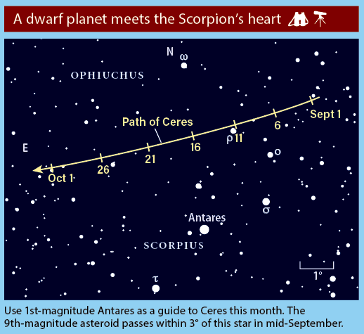

Even if you’re stuck in the suburbs, you’ll be able to spot a 9th-magnitude dwarf planet through a 3-inch telescope this month. Ceres has faded some since its late May peak, so it will be a challenge to see through binoculars. Several bright stars in the vicinity make the hunt easier, however, so it’s a good time to take another look at Ceres.
The dwarf planet lies near 1st-magnitude Antares, the ruddy supergiant that marks the heart of Scorpius the Scorpion. More importantly, the darkness behind Ceres helps it stand out. In August, Ceres floated in front of fields swarming with stars belonging to the Milky Way’s central bulge. But in September, it traverses star-poor dust lanes. What makes the journey even better for imagers are the super-photogenic swaths of red, blue, and yellow clouds of gas and dust that form the Rho (ρ) Ophiuchi complex.
On September 15, Ceres passes 2.9° north of Antares, and the closest star that outshines the asteroid lies 1° away. Identifying Ceres will be easy, but detecting its motion from night to night will be nearly impossible. For that, you need some nice reference stars. The best is Rho Oph itself, which stands 12′ south of Ceres on the 11th, though a few field stars perform admirably on September’s last few evenings. Simply sketch the positions of three or four stars and then add a dot for Ceres as it moves hour by hour.
