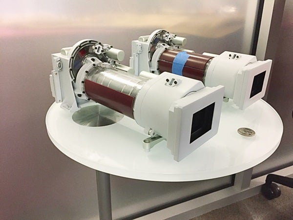

Mastcam-Z’s variable-zoom eyes can capture 3D (stereo) color images with resolutions of up to 1,600 by 1,200 pixels.

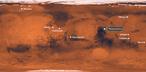

Mission scientists selected Perseverance’s landing site, Jezero Crater, after whittling down about 60 initial options considered to be “astrobiologically relevant.” At 30 miles (49 kilometers) wide, Jezero Crater is an ancient lake and delta system located at the western edge of a giant impact basin called Isidis Planitia, just north of Mars’ equator. Within Jezero, researchers have identified many appealing sites packed with minerals like clays, carbonates, and hydrated silica, which are of great interest due to their potential to preserve signatures of past life.
“One of the fantastic and fairly unique things about Jezero is not just that it was a crater lake, but that on the [northeast side] of that crater, there’s an outlet channel,” says deputy project scientist Ken Williford. This makes Jezero what scientists call an open system. “There’s water flowing in one side and out the other side, and so it would have been a dynamic system that survived for some significant amount of time. And in that sense, it would have been a fairly stable, habitable environment,” says Williford.
If certain minerals like carbonates were crystallizing at the same time that liquid water existed near the edges of Jezero Crater, Williford says, that’s the perfect situation for forming microbial mats. “Think pond scum at the edge of a pond or a lake,” he says. “Those carbonates can entomb that pond scum — these microbial mats — and form a kind of rock that we call a stromatolite, which really just means a layered rock. But often stromatolites are fossilized microbial mats.
“Another big one is the rocks at the bottom of the delta,” Williford adds. “That stuff that we find preserved right at the bottom of that beautiful delta in Jezero — that mud — is really fantastic at concentrating and preserving organic matter. And it often does that in a way that’s homogenized and jumbled up. It doesn’t necessarily preserve those beautiful fossilized structures that you might find at the edge of the lake. But most of the rocks on Earth that are the richest in organic matter are rocks that were formed in a muddy environment.”
Although Jezero has long been on scientists’ lists of intriguing Mars sites, previous missions have deemed it too challenging to safely land there. However, with Perseverance’s improved entry, descent, and landing technology, the titillating lake and delta system are now well within the rover’s reach.

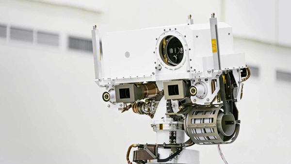

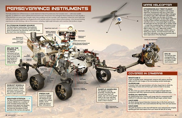

One vital remote-sensing instrument is the Mastcam-Z imaging system. As the rover chugs along the martian surface, it will rely on Mastcam-Z to both safely navigate and spot potentially biosignature-harboring rocks.
Located on the rover’s mast, Mastcam-Z stands about 6.5 feet (2 meters) above the martian surface, allowing it to get 360-degree views of the landscape with its two stereoscopic, zoomable eyes. Mastcam-Z is equipped with a range of filters, providing true-color vision that stretches a bit into the infrared and ultraviolet realms. This makes Mastcam-Z particularly sensitive to rocks containing water or hydrogen because, according to Bell, “different kinds of rocks and minerals reflect light differently in those wavelengths.”
ASYMA0620_06b
Engineers carefully install SuperCam on Perseverance last June in the Spacecraft Assembly Facility at the Jet Propulsion Laboratory in Pasadena, California.
NASA/JPL-Caltech
Mastcam-Z also has the ability to take high-definition video. From an engineering perspective, Bell says, the video can be used to confirm the rover’s intricate tools, like its drill and sample system, are working properly. “And the second reason? It’s just damn fun,” Bell says. “We think we’re going to try to take videos while we’re driving,” he adds. “And the microphones on the rover will be recording at the same time, so we can merge our video with the audio.”
Sharing the high perch with Mastcam-Z is Perseverance’s SuperCam instrument. According to Principal Investigator Roger Wiens, “SuperCam is kind of the eyes and ears and nose, if you will, of the [Perseverance] rover.” Although Mastcam-Z might be the first to identify promising sites, Wiens says SuperCam will serve as sort of an advance guard that will remotely characterize the chemistry, mineralogy, and physical properties of rock outcroppings.
SuperCam relies on a range of spectroscopic techniques to investigate targets from a distance. One such technique is called visible and infrared reflectance spectroscopy. This method is exceptionally powerful, Wiens says, because it’s a passive technique that only uses sunlight to distinguish between clays, carbonates, sulfates, silicates, phosphates, and other minerals from a great distance. “Really, it can go as far as you can see,” he says, “and so when visibility is good on Mars, then it could be kilometers.”
SuperCam also will utilize a technique called Laser-Induced Breakdown Spectroscopy (LIBS), which uses a 1,064-nanometer laser to study targets as small as a pencil point from up to about 23 feet (7 m) away. The basic idea of LIBS is that “you just need to blast the rock, and then you need to see the color spectrum of the material that you just blasted,” says Wiens. The first few laser shots — each powerful enough to light about a million lightbulbs but lasting just 4 billionths of a second — create a tiny shock wave that removes any dust from the rock’s surface, he says, providing a clear view of the target. After removing dust, additional shots vaporize pieces of rock, creating a plasma. By analyzing the specific colors of light present in this plasma, SuperCam can get an idea of what the rock is made of.
Once Mastcam-Z and SuperCam identify a promising target, the rover will trundle over to the target to take a closer look with two contact tools mounted to its robotic arm: the Planetary Instrument for X-ray Lithochemistry (PIXL) and the Scanning Habitable Environments with Raman & Luminescence for Organics & Chemicals (SHERLOC).
Before PIXL and SHERLOC begin collecting data up close, the rover will use an abrading drill bit to flatten a small, circular spot on a target rock about 1.5 inches (4 centimeters) wide, Williford said in a presentation at the Jet Propulsion Laboratory. It’s almost like preparing a slide for analysis with a microscope. But because this creates a lot of dust, the rover’s turret also includes the Gaseous Dust Removal Tool, which shoots puffs of ultra-pure nitrogen that will help clear away any debris generated during the abrading process. After that, the site’s ready for up-close inspection with PIXL and SHERLOC.
The PIXL instrument has an X-ray fluorescence spectrometer that reveals the specific elements embedded within a rock. “X-ray fluorescence is a technique that is considered to be the gold standard of measuring [the elemental] chemistry of rocks,” says Abigail Allwood, principal investigator of PIXL. “But having said that, it’s usually done in bulk.”

In bulk analysis, like Curiosity does with its Alpha Particle X-Ray Spectro­meter, “you take rock, powder it up, and take an average measurement of the entire sample,” Allwood says. PIXL instead uses an X-ray beam about as wide as a human hair to scan an area roughly the size of a postage stamp. This allows researchers to create a highly detailed map of the entire target area, showing where more than 25 elements conducive to life are concentrated, down to levels in the tens-of-parts-per-million range.
Sharing Perseverance’s turret is SHERLOC, a laser-based tool that likewise scans rocks, but uses an ultraviolet beam about as wide as PIXL’s X-ray beam. Unlike PIXL, SHERLOC charts the molecular composition of rocks using multiple spectroscopic methods. This allows researchers to map the specific locations of minerals and organic matter that are commonly associated with life.
“We are very sensitive to any minerals or mineralogy or chemistry that was done in an aqueous environment,” says Luther Beegle, principal investigator of SHERLOC. “So a lot of the stuff we talk about looking at — phyllosilicates, clays, gypsum, things like that — are all associated with liquid water.” Because scientists understand how these minerals are formed, he says, SHERLOC can help researchers rewind the clock to better understand what the varied environments within Jezero Crater were like billions of years ago.
But where would SHERLOC be without WATSON (the Wide Angle Topographic Sensor for Operations and eNgineering)? According to Beegle, this subsystem of SHERLOC captures visual images of target areas to provide more context for these sites, complementing PIXL’s elemental maps and SHERLOC’s molecular maps.

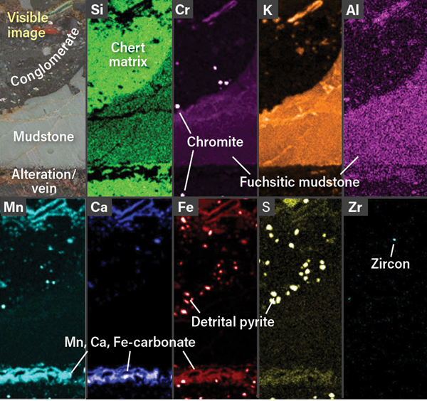

ASYMA0620_07
PIXL’s X-ray beam causes certain elements to fluoresce at specific wavelengths, allowing researchers to create a detailed map of the precise elemental composition of a sample.

But these aren’t the only tools Perseverance has in its sophisticated toolbelt. The rover also includes a gadget that will dramatically help researchers characterize the geology and past habitability of Mars, aiding in their search for ancient biosignatures.
After Mastcam-Z and SuperCam look around the landscape in search of notable features, but before PIXL and SHERLOC come into play, Perseverance will deploy its Radar Imager for Mars’ subsurFAce eXperiment (RIMFAX) — the very first ground-penetrating radar tool ever sent to the martian surface.
This pioneering instrument will reveal buried features, such as ancient lava flows or sand dunes, that will help researchers weave together a more comprehensive history of Mars’ past habitability, helping them hunt for ancient life. Furthermore, thanks to RIMFAX’s ability to detect water, ice, or salty brine buried at a depth of more than 33 feet (10 m), scientists can pinpoint locations rich in natural resources that might one day be tapped by human explorers.

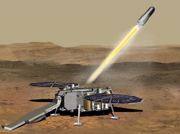

NASA’s Mars Ascent Vehicle, seen in this artist’s concept, would ferry rock and soil samples collected by Perseverance into martian orbit. The samples would then hitch a ride to Earth aboard another spacecraft.

Although the specifics of a return mission are still nebulous, the basic idea is that a future spacecraft will land on Mars and deploy a small rover to collect the cached cores that Perseverance will leave behind. This worker-bee rover will load the samples into a small rocket (tentatively called a Mars Ascent Vehicle), which will blast them into martian orbit. There, they’ll be handed off to an orbiting spacecraft for return to Earth.
Finally, NASA will divvy up and distribute the samples to science labs around the world. Over the ensuing decades, Williford says, researchers will scrutinize the samples with the most sophisticated instruments on Earth (as well as some instruments that haven’t been invented yet) therefore “maximizing our ability to detect signs of ancient life or extremely subtle signs of planetary evolution.” And based on what we’ve learned from analyzing the Apollo lunar samples in Earth-based labs, getting our hands on intact Mars samples would teach us much more than any rover-mounted instruments ever could.

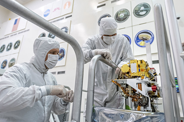

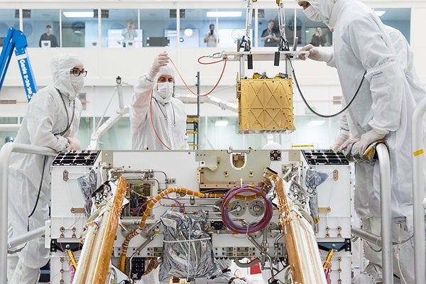

Engineers gently lower the MOXIE instrument into its place on the Perseverance rover. MOXIE will pioneer a method for pulling usable oxygen from the carbon dioxide-heavy atmosphere of Mars.

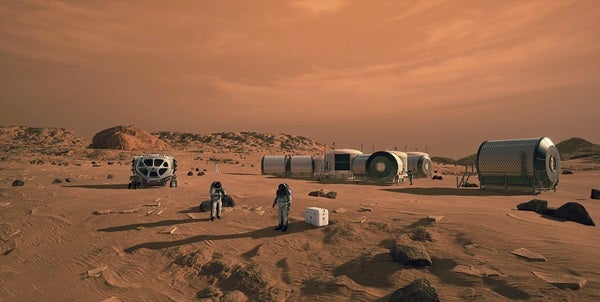

Preparing for humans
Despite the recent focus on the Artemis program, which aims to send humans back to the Moon within the decade, many of those working on Perseverance aren’t too concerned with the prospect of the Moon trumping their goal of sending humans to Mars. And because of their steadfast belief that humanity will eventually make it to the Red Planet, they’re taking the pragmatic approach and doing some basic prep work. “The more we know about Mars,” Williford says, “the better prepared we are to send humans there and get them home safely.”

Thanks to forward-thinking missions like Perseverance, the idea of humans on Mars doesn’t seem as far-fetched as it once did.

Then there’s the Mars Oxygen In-Situ Resource Utilization Experiment (MOXIE), one of the first experiments designed to test the extraterrestrial production of something we’ll need to survive on (and return from) Mars. Its mission: plucking oxygen from the martian atmosphere.
One day we might harvest oxygen from water ice already trapped in Mars’ poles, says Michael Hecht, MOXIE’s principal investigator. But in the short term, “the thing that’s really easy to do is be an electronic tree,” he says. “What does a tree do? It takes in [carbon dioxide]; it puts out oxygen.”
MOXIE will use electricity to break apart carbon dioxide molecules — which make up about 96 percent of Mars’ thin atmosphere — into carbon monoxide and oxygen. However, MOXIE needs to be careful not to push the electrolysis-based process too far, which would knock lone carbon atoms from the carbon monoxide molecules. The danger of this is that carbon is very difficult to deal with, Hecht says. “Carbon is actually how you destroy these [mechanical] systems, because the carbon builds up and they stop working.”
Even if MOXIE can avoid getting gunked up with excess carbon, it’s still just a proof-of-concept experiment that will need to be dramatically scaled up — by hundreds of times — before any crewed missions venture to Mars. When it is running, which will likely only be about once a month, Hecht says MOXIE might be able to produce around 10 grams of oxygen per hour, but it’ll probably be closer to 6 g. (For reference, humans need about 20 g of oxygen per hour to breathe.) But breathable oxygen is just a small part of the larger battle.
