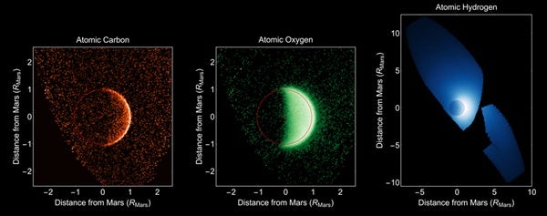

MAVEN initial data
Three views of an escaping atmosphere, obtained by MAVEN’s Imaging Ultraviolet Spectrograph. By observing all of the products of water and carbon dioxide breakdown, MAVEN’s remote sensing team can characterize the processes that drive atmospheric loss on Mars.
University of Colorado/NASA

The hydrogen and oxygen coronas of Mars are the tenuous outer fringe of the planet’s upper atmosphere, where the edge of the atmosphere meets space. In this region, atoms that were once a part of carbon dioxide or water molecules near the surface can escape to space. These molecules control the climate, so following them allows astronomers to understand the history of Mars over the last 4 billion years and to track the change from a warm and wet climate to the cold, dry climate we see today. MAVEN observed the edges of the martian atmosphere using the Imaging Ultraviolet Spectrograph (IUVS), which is sensitive to the sunlight reflected by these atoms.
“With these observations, MAVEN’s IUVS has obtained the most complete picture of the extended martian upper atmosphere ever made,” said MAVEN Remote Sensing Team member Mike Chaffin of the University of Colorado, Boulder. “By measuring the extended upper atmosphere of the planet, MAVEN directly probes how these atoms escape to space. The observations support our current understanding that the upper atmosphere of Mars, when compared to Venus and Earth, is only tenuously bound by the Red Planet’s weak gravity.”
