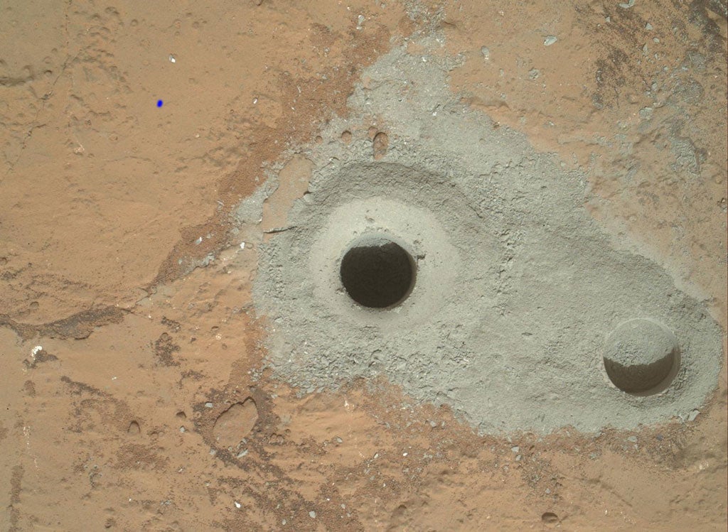

At the center of this image from NASA’s Curiosity rover is the hole in a rock called “John Klein” where the rover conducted its first sample drilling on Mars. The drilling took place on February 8, 2013, or Sol 182, Curiosity’s 182nd martian day of operations. Several preparatory activities with the drill preceded this operation, including a test that produced the shallower hole on the right two days earlier, but the deeper hole resulted from the first use of the drill for rock sample collection. // NASA/JPL-Caltech/MSSS
NASA’s Curiosity rover has, for the first time, used a drill carried at the end of its robotic arm to bore into a flat, veiny rock on Mars and collect a sample from its interior. This is the first time any robot has drilled into a rock to collect a sample on Mars.
The fresh hole, about 0.63 inch (1.6 centimeters) wide and 2.5 inches (6.4cm) deep in a patch of fine-grained sedimentary bedrock, can be seen in images and other data that Curiosity beamed to Earth on Saturday. The rock is believed to hold evidence about long-gone wet environments. In pursuit of that evidence, the rover will use its laboratory instruments to analyze rock powder the drill collects.

Rock powder generated during drilling travels up flutes on the bit. Chambers in the bit assembly hold the powder until it can be transferred to the sample-handling mechanisms of the rover’s CHIMRA device, which stands for Collection and Handling for In-Situ Martian Rock Analysis.
Before the rock powder is analyzed, some will be used to scour traces of material that may have been deposited onto the hardware while the rover was still on Earth, despite thorough cleaning before launch.
“We’ll take the powder we acquired and swish it around to scrub the internal surfaces of the drill bit assembly,” said JPL’s Scott McCloskey, drill-systems engineer. “Then we’ll use the arm to transfer the powder out of the drill into the scoop, which will be our first chance to see the acquired sample.”
The chief engineer for Curiosity’s sample system, JPL’s Louise Jandura, said, “Building a tool to interact forcefully with unpredictable rocks on Mars required an ambitious development and testing program. To get to the point of making this hole in a rock on Mars, we made eight drills and bored more than 1,200 holes in 20 types of rock on Earth.”
Inside the sample-handling device, the powder will be vibrated once or twice over a sieve that screens out any particles larger than six-thousandths of an inch (150 microns) across. Small portions of the sieved sample will fall through ports on the rover deck into the Chemistry and Mineralogy (CheMin) instrument and the Sample Analysis at Mars (SAM) instrument. These instruments then will begin the much-anticipated detailed analysis.
