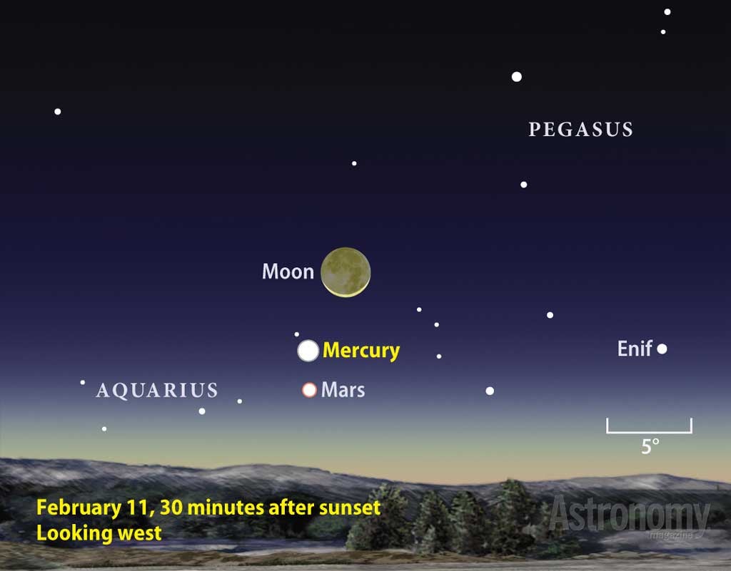

We begin our tour low in the western sky shortly after sunset. The deepening twilight offers a pretty background for observers seeking their first glimpse of Mercury during 2013. The innermost planet reached superior conjunction (when it passed on the far side of the Sun from Earth) January 18, and it spends the first two weeks of February climbing higher in the evening sky. On the 1st, Mercury shines brightly at magnitude –1.1 and sets nearly 50 minutes after the Sun. You should be able to spot it through binoculars some 3° high in the west-southwest about a half-hour after sunset.
With each passing day, Mercury appears a little higher and becomes slightly easier to see. Be sure to look February 8, when it passes 0.3° north of Mars. The inner planet then shines at magnitude –1.0, some eight times brighter than Mars. You almost certainly will need binoculars to spy the Red Planet against the glowing twilight. Three nights later, on February 11, a slender crescent Moon stands 5° north of Mercury.
The planet’s visibility continues to improve through its February 16 greatest elongation from the Sun. On that date, Mercury lies 18° east of our star and appears 11° high in the west-southwest 30 minutes after sundown. Glowing at magnitude –0.6, it is the brightest object in the area. The planet slides back toward the Sun after this peak and disappears in bright twilight by month’s end.

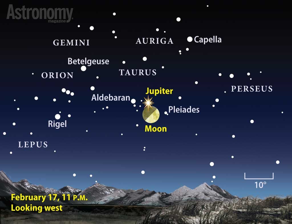

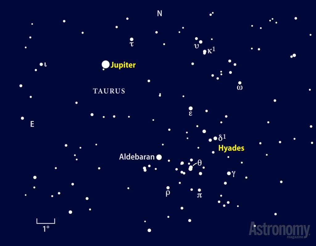

Although no one would claim that Mercury, Mars, or Uranus is easy to see, you can’t miss the fourth planet visible on February evenings. Jupiter commands the sky as darkness falls. At magnitude –2.4, it shines far brighter than any other point of light in the sky. And from mid-northern latitudes, the giant planet peaks 70° above the southern horizon shortly
after sunset.
But as great as Jupiter looks to the naked eye and with binoculars, it truly stands out through a telescope. Living up to its name, the giant planet spans 43″ in early February and shrinks by less than 10 percent as it draws away from Earth during the month. In moments of good seeing — most common when the massive world lies high in the early evening sky — dramatic cloud features pop into view. Look for an alternating series of bright zones and darker belts that run parallel to the jovian equator.

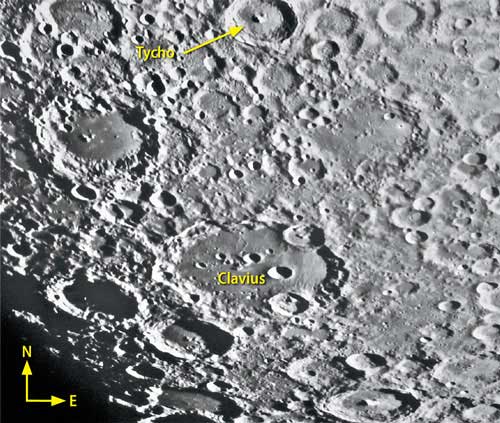

Mention Tycho and Clavius to any lunar observer, and watch a smile cross his or her face. These two southern hemisphere craters stand out in a magnificent play of light and shadow when the Sun rises over them February 19. Although Tycho’s normally brilliant ray system doesn’t show up at this waxing gibbous phase, the crater’s deep bowl, sharp rim, and well-defined central peak appear prominent even in the crowded southern highlands.
With a diameter of 140 miles, Clavius is more than 2.5 times wider than its northern neighbor. This giant feature has a softer rim than Tycho, a direct consequence of its greater age. Tycho formed when an asteroid-sized object struck the Moon approximately 108 million years ago. In contrast, the massive impact that created Clavius occurred some 4 billion years ago. This means far more solar system debris has had a chance to batter Clavius. Take a closer look inside this shallow bowl, and you’ll see a curving chain of smaller impact features.
As the February 25 Full Moon approaches, Tycho’s rays become more obvious. Note a darker ring around this crater’s raised rim. Heat from the impact partially melted and darkened the surrounding surface.

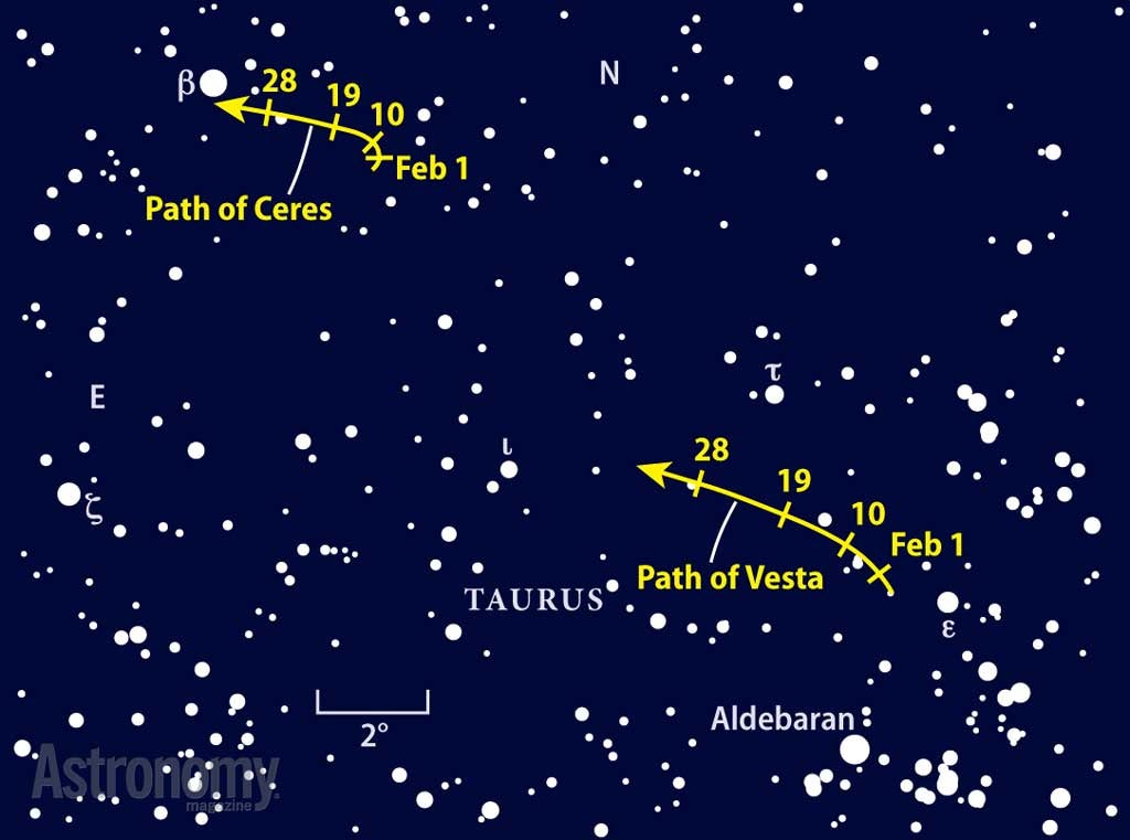

You can double your fun this month by following the two brightest asteroids — 1 Ceres and 4 Vesta — as they trace nearly parallel tracks barely 10° apart. The pair lies among the stars of Taurus the Bull, with 1st-magnitude Aldebaran nearby and brilliant Jupiter not much farther away. The asteroids remain within reach of binoculars from rural locations and are easy pickings through a small scope from the city.
Although they both reached their peak in December, these rocky bodies still glow at 8th magnitude. The bright guide stars of Taurus will make them easy to track with the help of the finder chart below. And the dust and cold gas in our galaxy’s disk help dim the throngs of background stars in the Milky Way that would otherwise make this a more challenging observation.
As February opens, Vesta lies just 3° north of Aldebaran; Ceres closes to within 1° of 2nd-magnitude Beta (β) Tauri at month’s end. If you return to these areas every few days, you can see their motions easily. Although the two seem close now, just wait — in the summer of 2014, these space rocks will appear less than 1° apart.
