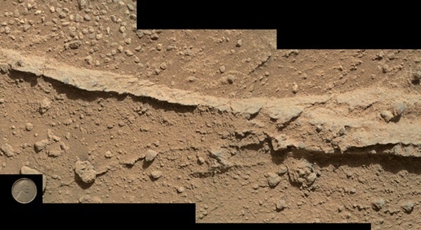

This mosaic of four images taken by the Mars Hand Lens Imager (MAHLI) camera on NASA’s Mars rover Curiosity shows detailed texture in a ridge that stands higher than surrounding rock. The rock is at a location called “Darwin,” inside Gale Crater. Exposed outcrop at this location, visible in images from the High Resolution Imaging Science Experment (HiRISE) camera on NASA’s Mars Reconnaissance Orbiter, prompted Curiosity’s science team to select it as the mission’s first waypoint for several days during the mission’s long trek from the “Glenelg” area to Mount Sharp.

“We examined pebbly sandstone deposited by water flowing over the surface and veins or fractures in the rock,” said Dawn Sumner from the University of California, Davis. “We know the veins are younger than the sandstone because they cut through it, but they appear to be filled with grains like the sandstone.”

“We want to understand the history of water in Gale Crater,” Sumner said. “Did the water flow that deposited the pebbly sandstone at Waypoint 1 occur at about the same time as the water flow at Yellowknife Bay? If the same fluid flow produced the veins here and the veins at Yellowknife Bay, you would expect the veins to have the same composition. We see that the veins are different, so we know the history is complicated. We use these observations to piece together the long-term history.”
Researchers set the top priority for the Waypoint 1 stop to be examination of a conglomerate rock outcrop, such as the pebbly sandstone. The veins were a bonus.
“As often happens, the closer we get, the more is revealed,” said Kenneth Williford of NASA’s Jet Propulsion Laboratory (JPL) in Pasadena, Californoia. The first specific location at Waypoint 1 for parking the rover and using the instruments on its arm was selected because images taken from nearly a football-field’s length away showed outcrops that looked like conglomerate. Once Curiosity approached that location, new images showed the veins, so mission scientists added a second location for use of the arm to the plan.
The rover spent one day using its arm at the first location and three more using its arm at the second location. On all four of these “contact-science” days, the investigations employed two instruments that are mounted in the turret at the end of the arm: the Alpha Particle X-ray Spectrometer, which identifies chemical elements present in a target, and the Mars Hand Lens Imager, which shows targets’ textures, shapes, and colors.
