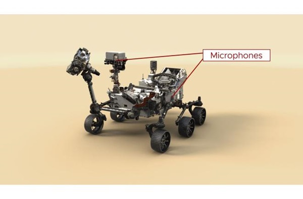

Chide completed his Ph.D. in 2020 at the University of Toulouse with planetary scientists Sylvestre Maurice and David Mimoun, who collaborated with a team at Los Alamos to build an instrument called SuperCam. SuperCam is mounted on Perseverance’s mast and houses one of the rover’s two microphones; the other mic is located in a camera on the rover’s side. It was Chide’s job as a Ph.D. student to devise the scientific rationale that would persuade NASA that the mics were indeed a valuable asset. And the stakes were high: Chide’s entire thesis project hinged upon getting those mics into space. “It was a risky bet,” he says — but one that paid off.

Without the bustle of humans and animals, Mars is nearly silent, save the gusty wind. So, the SuperCam team also decided to analyze the sounds coming from their own scientific equipment.
Part of SuperCam’s job is to zap nearby rocks with a laser and record the acoustic and optical signals that reverberate back, in order to determine hardness and chemical composition. The mic was also able to pick up farther away sounds, including the whir of the blades on NASA’s Ingenuity helicopter — the first aircraft to make a powered, controlled flight on another planet.
