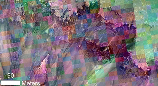

This image combines a photograph of seasonal dark flows on a martian slope with a grid of colors based on data collected by a mineral-mapping spectrometer observing the same area.
NASA/JPL-Caltech/UA/JHU-APL

Ojha and James Wray of Georgia Tech more recently looked at 13 confirmed RSL sites using images from the same orbiter’s Compact Reconnaissance Imaging Spectrometer for Mars (CRISM) instrument. They searched for minerals that RSL might leave in their wake as a way of understanding the nature of these features: Water-related or not?
They didn’t find any spectral signature tied to water or salts, but they did find distinct and consistent spectral signatures of ferric and ferrous minerals at most of the sites. These iron-bearing minerals were more abundant or featured distinct grain sizes in RSL-related materials as compared to non-RSL slopes.
Ojha said, “Just like the RSL themselves, the strength of the spectral signatures varies according to the seasons. They’re stronger when it’s warmer and less significant when it’s colder.”
One possible explanation for these changes is a sorting of grain sizes, such as removal of fine dust from the surface, which could result from either a wet process or dry one. Two other possible explanations are an increase in the more oxidized (ferric) component of the minerals or an overall darkening due to moisture. Either of these would point to water, even though no water was directly detected. The spectral observations might miss the presence of water, because the dark flows are much narrower than the area of ground sampled with each CRISM reading. Also, the orbital observations have been made only in afternoons and could miss morning moisture.
