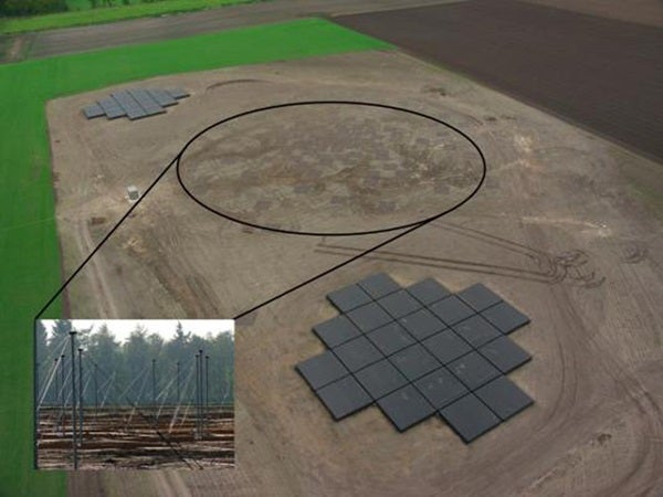

The first complete LOFAR station, located near Exloo, Drenthe. This station was one of several that performed the first astronomical observations. The photo shows the different LOFAR low-band and high-band antennas.
