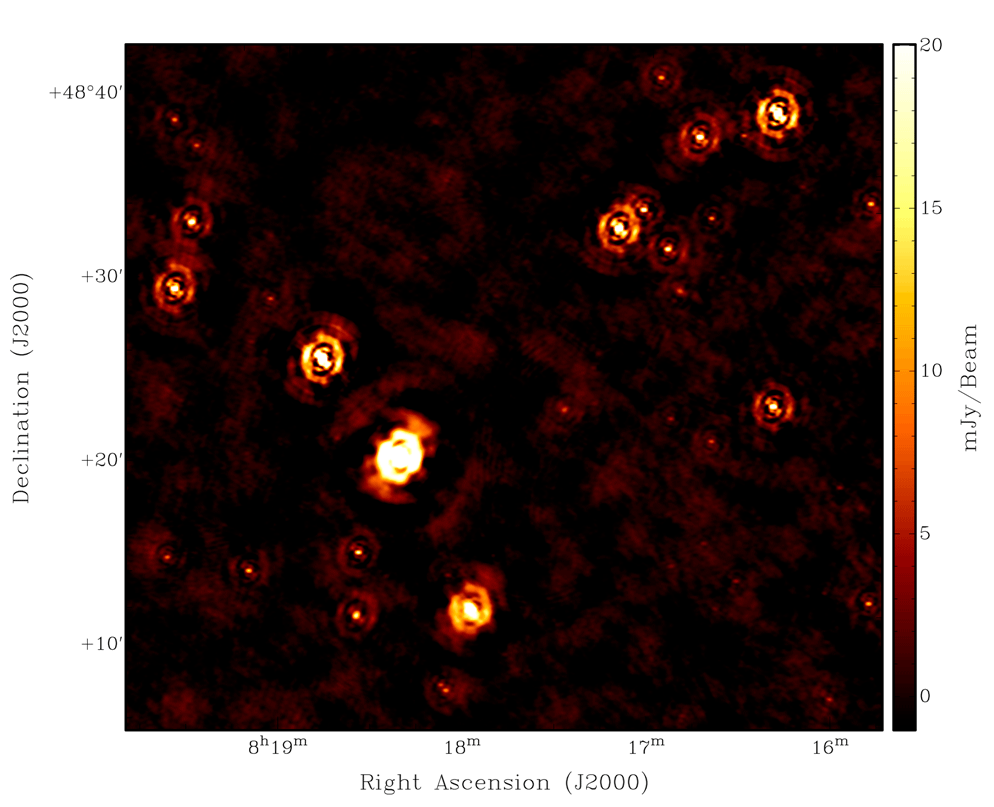

Cutouts from a very small part of the giant images are shown in the associated figures. One of the fields is centered at the North Celestial Pole, which is special in the sense that nighttime observations can be obtained all year round. The second field was centered at the bright compact quasar 3C 196 in the constellation Lynx. The images, which have a resolution of 8 arcseconds, are already comparable to, or even slightly better, than the best published images taken with the Giant Meter-wavelength Radio Telescope (GMRT) in India. The images contain a large number of both very bright and very faint sources, spanning a so-called dynamic range of more than 200,000:1 in brightness between sources in the 3C 196 image.
This is an important record for the time being for LOFAR. The image quality, however, is still not perfect, and significant improvements can be expected in the months ahead using improved knowledge of the effects of the LOFAR station beams. Continued efforts are also needed to improve the software to deal with imaging artifacts and the ionosphere. These two fields and several others will be observed for about 100 nights to conclusively detect signals from the EoR.
