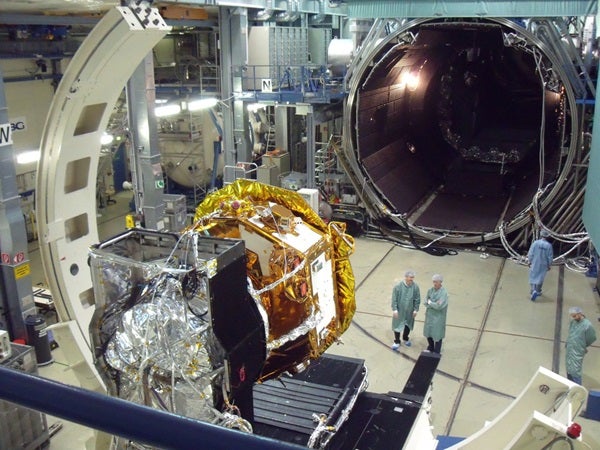

The Optical Metrology Subsystem underwent its first full tests under space-like temperature and vacuum conditions using an almost complete version of the spacecraft.
The results exceeded the precision required to detect the enigmatic ripples in the fabric of space and time predicted by Albert Einstein — and did it by two to three times.
In space, the LISA Pathfinder will measure the distance between two free-floating gold-platinum cubes using lasers. In the ground tests currently being performed by the team in Ottobrunn, Germany, separate mirrors replace these cubes.
In addition to measuring the distance between the cubes, it also measures their angles with respect to the laser beams — and the tests show an accuracy of 10 trillionths of a degree.
“This is equivalent to the angle subtended by an astronaut’s footprint on the Moon!” said Paul McNamara from ESA.

The instrument team from Astrium GmbH, the Albert Einstein Institute, and ESA are testing the Optical Metrology Subsystem during LISA Pathfinder’s thermal vacuum tests in Ottobrunn by spacecraft prime contractor Astrium in the United Kingdom.
