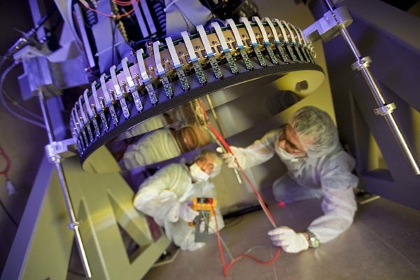

Side view of the Adaptive Optics system during lab testing. The deformable reflecting surface of the concave mirror is visible, along with some of the 672 circuit cards that control the magnetic forces.

This outstanding success was achieved through the combination of several innovative technologies. The first is the secondary mirror, which was designed from the start to be a main component of the LBT rather than an additional element as on other telescopes. The concave secondary mirror is 3 feet (0.91 meter) in diameter and only .06 inch (1.6 millimeters) thick. The mirror is so thin and pliable that it can easily be manipulated by actuators pushing on 672 tiny magnets glued to the back of the mirror, a configuration that offers far greater flexibility and accuracy than previous systems on other telescopes. An innovative “pyramid” sensor detects atmospheric distortions and manipulates the mirror in real time to cancel out the blurring, allowing the telescope to literally see as clearly as if there was no atmosphere. Incredibly, the mirror is capable of making adjustments every 1-thousandth of a second with accuracy to better than 10 nanometers — a nanometer is one-millionth the size of a millimeter.
