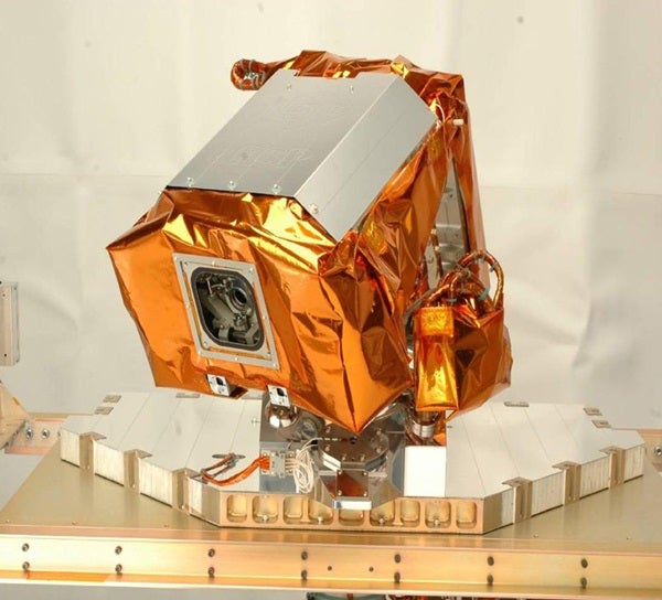

Total Irradiance Monitor
Better satellite instruments are improving measurements of solar energy reaching Earth. Exactly determining the contribution of solar fluctuations to rising global temperature is expected to become possible as new instruments, such as the Total Irradiance Monitor above, further refine solar measurements. The device is scheduled to launch next month on NASA’s Glory spacecraft.

The LASP-built Total Irradiance Monitor (TIM) instrument on the NASA Solar Radiation and Climate Experiment (SORCE) spacecraft measured the new lower TSI value. Tests at a new calibration facility at LASP verify the lower TSI value. The ground-based calibration facility enables scientists to validate their instruments under on-orbit conditions against a reference standard calibrated by the National Institute of Standards and Technology (NIST). Before the development of the calibration facility, solar irradiance instruments would frequently return different measurements from each other, depending on their calibration. To maintain a long-term record of the Sun’s output through time, scientists had to rely on overlapping measurements that allowed them to intercalibrate among instruments.
“The calibration facility indicates that the TIM is producing the most accurate total solar irradiance results to date, providing a baseline value that allows us to make the entire 32-year record more accurate,” said Kopp. “This baseline value will also help ensure that we can maintain this important climate data record for years into the future, reducing the risks from a potential gap in spacecraft measurements.”
