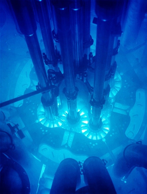

Cherenkov radiation can be seen around nuclear reactors when particles exceed the speed of light in water. Tachyons might create such a glow in empty space.
Argonne National Laboratory

If an electrically charged particle moves faster than the speed of light in a given medium (which is allowed by special relativity), it makes the optical analog of a sonic boom, a cone of light called Cherenkov radiation. If tachyons were electrically charged, they could produce Cherenkov radiation in empty space.
