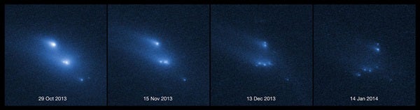

Asteroid P/2013 R3
This series of images shows the asteroid P/2013 R3 breaking apart, as viewed by the NASA/ESA Hubble Space Telescope in 2013. This is the first time that such a body has been seen to undergo this kind of break-up.
The Hubble observations showed that there are 10 distinct objects, each with comet-like dust tails, embedded within the asteroid’s dusty envelope. The four largest rocky fragments are up to 200 meters in radius.
NASA, ESA, D. Jewitt (UCLA)
The NASA/ESA Hubble Space Telescope has photographed the never-before-seen breakup of an asteroid, which has fragmented into as many as 10 smaller pieces. Although fragile comet nuclei have been seen to fall apart as they approach the Sun, nothing like the breakup of this asteroid, P/2013 R3, has ever been observed before in the asteroid belt.

“Keck showed us that this thing was worth looking at with Hubble,” Jewitt said. With their superior resolution, the space-based Hubble observations soon showed that there were really 10 distinct objects, each with comet-like dust tails. The four largest rocky fragments are up to 700 feet (200 meters) in radius.
The Hubble data showed that the fragments are drifting away from each other at a leisurely 0.9 mph (1.5 km/h) — slower than the speed of a strolling human. The asteroid began coming apart early last year, but the latest images show that pieces continue to emerge.

This leaves a scenario in which the asteroid is disintegrating due to a subtle effect of sunlight that causes the rotation rate to slowly increase over time. Eventually, its component pieces gently pull apart due to centrifugal force. Scientists have discussed the possibility of disruption by this phenomenon — known as the YORP effect —for several years but, so far, they have never reliably observed it.
For breakup to occur, P/2013 R3 must have a weak fractured interior, probably the result of numerous ancient and non-destructive collisions with other asteroids. Most small asteroids probably have been severely damaged in this way, giving them a “rubble pile” internal structure. P/2013 R3 itself is probably the product of collisional shattering of a bigger body some time in the past billion years.
