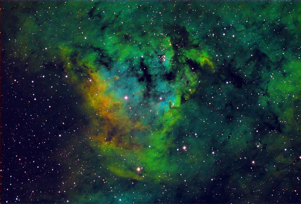

Photo-2
Photo 2: Running the image through Photoshop‘s “Lab Color” to increase color saturation helps make the colors more vivid, but one step remains to separate them more.
First, open your 16-bit TIFF photo and go to “Image” > “Mode” > “Lab Color.” Photoshop then separates your image into its luminance and color components. Use an “S” curve in “Curves” (see my February 2012 column) to increase the color saturation of your image. Then, convert the image back to RGB. Note that the amount of saturation will be equal to the intensity of the “S” curve that you generated in “Curves.” The result should look something like Photo 2.

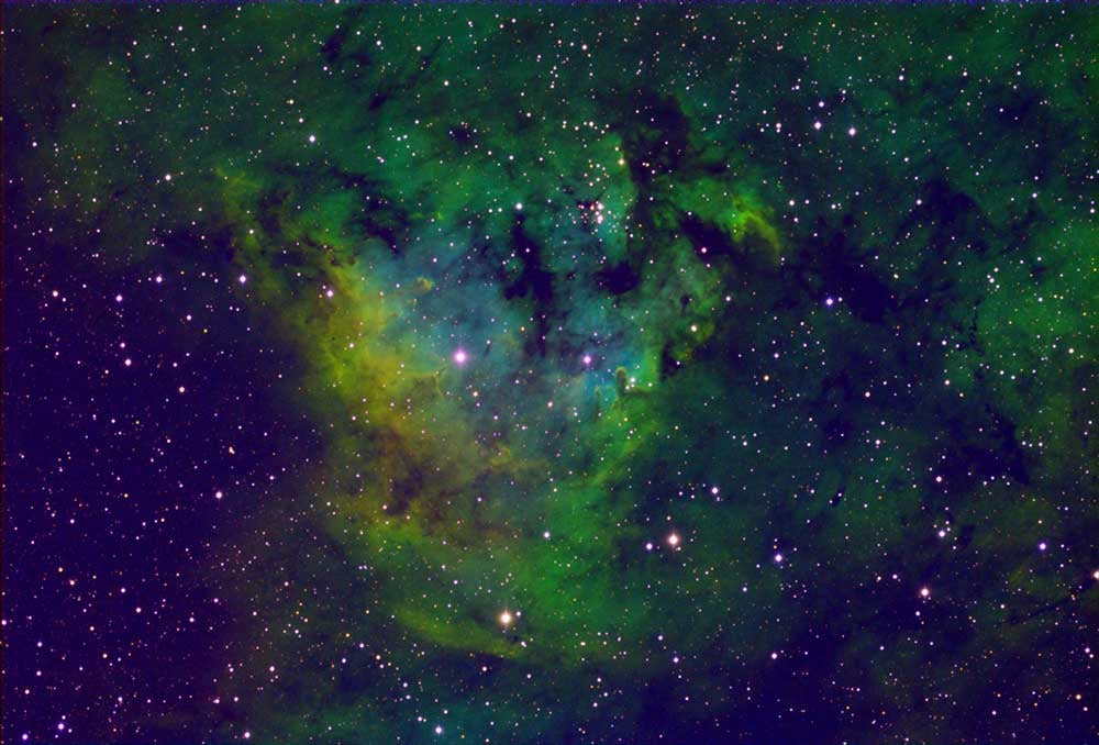

Now, here is where you get to use some poetic license. In this case, we want to use the Hubble palette but at the same time create as much difference as possible between the colors. Open your post-“Lab Color” photo and select “Image” > “Adjustments” > “Selective Color.” After taking a good look at the basic colors of the image, you can emphasize and “cultivate” each one. Here’s what I did:
Photo-3
Photo 3: By using “Selective Color,” you can tweak and “cultivate” each of your photo’s basic colors, resulting in a much more dramatic image.
CYAN = cyan +40, magenta –40, yellow –40, black –10.
YELLOW = cyan –40, magenta +0, yellow +40.
BLUE = cyan +20, magenta –30, yellow +40, black +10.
GREEN = magenta –40, yellow +40, black –10.
MAGENTA = cyan +20, magenta –20, yellow +20, black +10.
These settings affected the targeted colors, making them stronger and removing any spurious colors I didn’t want. The final result is Photo 3.
