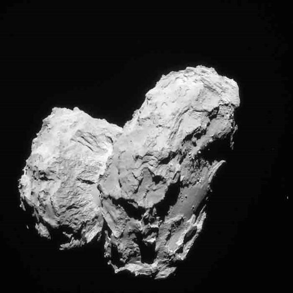

Two comets collided at low speed in the early solar system to give rise to the distinctive “rubber duck” shape of Comet 67P/Churyumov-Gerasimenko, said Rosetta scientists.
The origin of the comet’s double-lobed form has been a key question since Rosetta first revealed its surprising shape in July 2014.

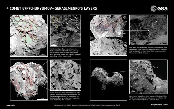

To reach their conclusion, Massironi and his colleagues first used images to identify over 100 terraces seen on the surface of the comet, and parallel layers of material clearly seen in exposed cliff walls and pits. A 3-D shape model was then used to determine the directions in which they were sloping and to visualize how they extend into the subsurface.
It soon became clear that the features were coherently oriented all around the comet’s lobes and in some places extended to a depth of about 2,100 feet (650 meters).
“This was the first clue that the two lobes are independent, reinforced by the observation that the layers are inclined in opposite directions close to the comet’s neck,” said Massironi.

Layers on Comet 67P’s surface.
ESA/Rosetta/MPS for OSIRIS Team MPS/UPD/LAM/IAA/SSO/INTA/UPM/DASP/IDA; M. Massironi et al. (2015)
“To be sure, we also looked at the relationship between the local gravity and the orientations of the individual features all around the reconstructed comet surface.”
Broadly speaking, layers of material should form at right angles to the gravity of an object. The team used models to compute the strength and direction of the gravity at the location of each layer.
In one case, they modeled the comet as a single body with a center of mass close to the neck. In the other, they worked with two separate comets, each with its own center of mass.
The team found that orientation of a given layer and the direction of the local gravity are closer to perpendicular in the model with two separate objects, rather than in the one with a single combined nucleus.
