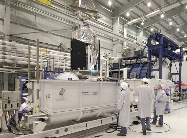

NASA's NuSTAR telescope
NASA’s NuSTAR X-ray observatory is one of the many tools astronomers currently use to study the accretion disks around black holes in detail.
