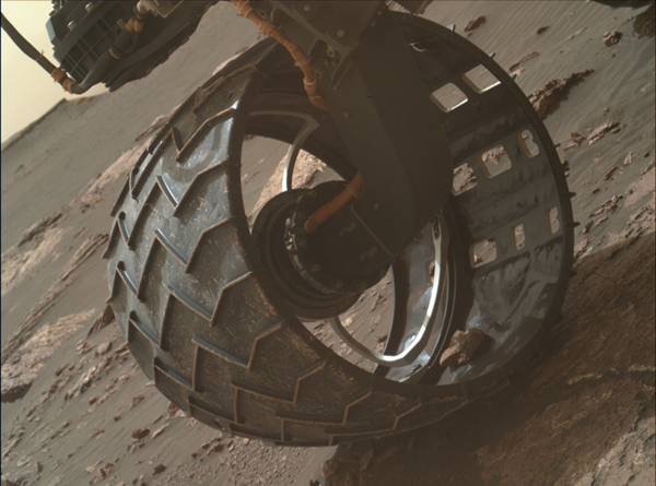

Looking at pictures of the rock inside the wheel, Mars spacecraft engineer Kristin Block of University of Arizona’s Lunar and Planetary Laboratory idly asked: how loud would the rock sound?

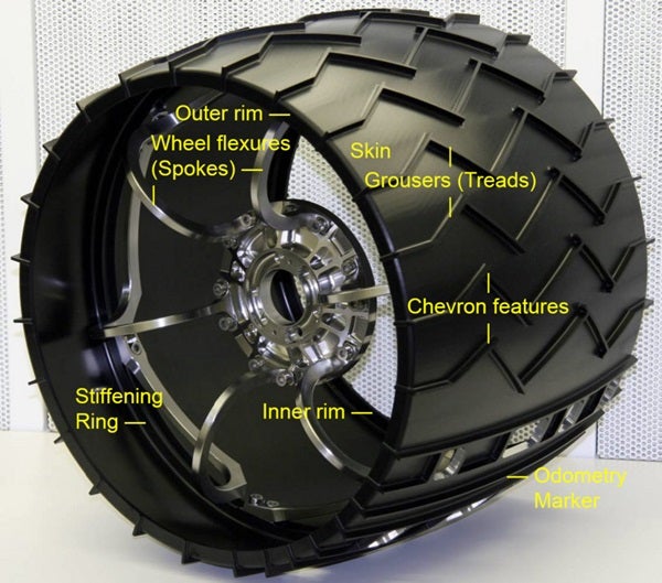

Curiosity is a robotic (uncrewed) car-sized vehicle with six wheels. Each of those wheels is 20 inches (50 centimeters) and 16 inches (40 centimeters) wide, with holes in the wheel designed to make it easy to show how far the rover has traveled when looking back over its tracks (which you can see in the image below). To monitor its health, Curiosity has a camera designed to check those wheels, along with anything else on the robot’s exterior. That’s how we know about the rock. From the pictures, it looks like the rock is about 2 inches (5 centimeters) across, big enough to be noticeable and much bigger than the holes in the wheels.
However, Curiosity’s top speed is centimeters per second, or about 0.09 miles per hour. At that sloth-like speed, Mars’ extremely rough terrain is less likely to damage the rover. It also means a rock inside Curiosity’s wheel won’t be like throwing a brick into a clothes dryer. Instead, the rock seemed to slide up and down as the rover moved, and eventually fell out again. In fact, this isn’t even the first rock to get into the wheels.
It doesn’t look like it is tumbling that much. More swish, less clang. =)

20140818_wheeldiagram_f840
NASA / JPL / Emily Lakdawalla
