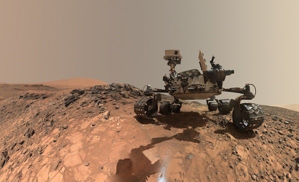

pia19808main_tight_cropmonday
NASA-JPL
Mars rover Curiosity now has its own built-in curiosity.
NASA recently installed a new AI system called AEGIS to autonomously choose targets for its laser detection system.
The AEGIS algorithm analyzes images taken by the rover’s navigation camera (Navcam). AEGIS can select a target rock and pinpoint it with the rover’s laser system, ChemCam, before scientists on Earth have time to look at the images. ChemCam then determines what kinds of atoms the rock contains. The new autonomy is especially useful when Curiosity is in the middle of a long drive, or when there are delays in sharing information with scientists on Earth.
