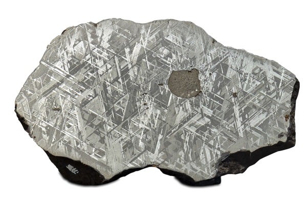

The intricate, interleaving layers of Widmanstätten patterns are due to differing levels of nickel in alloys found in meteorites. As the meteorite cools, a nickel-rich alloy solidifies sooner and forms layers along the other alloy.

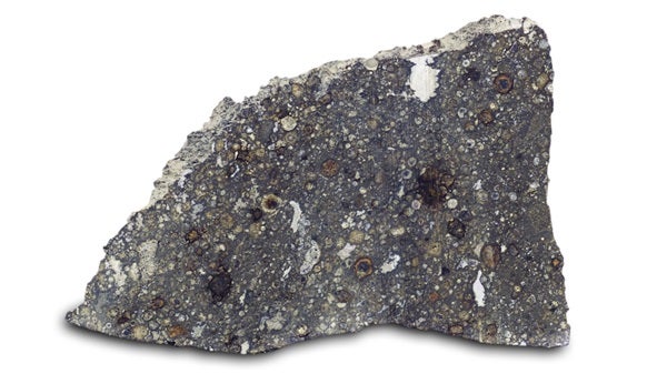

This cross-section of an Allende meteorite fragment reveals the circular outlines of chondrules, formed from molten silicate droplets. The irregular white objects are known as calcium-aluminum-rich inclusions.
James St. John (CC-BY-2.0)

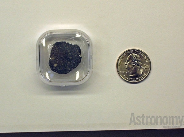

Inclusions in the Allende meteorite, which fell in Mexico in 1969, date back 4.55 billion years. This carbonaceous chondrite stone meteorite contains solidified drops of minerals from the ancient solar system.
Astronomy: David J. Eicher
