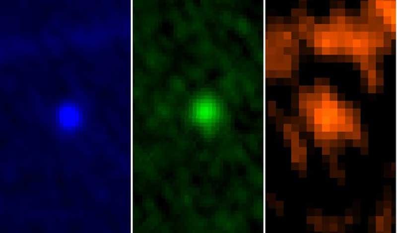

Herschel’s three-color view of asteroid Apophis. // Credit: ESA
The European Space Agency’s (ESA) Herschel Space Observatory made new observations of asteroid Apophis as it approached Earth. The data shows the asteroid is bigger than first estimated and less reflective.

Herschel provided the first thermal infrared observations of Apophis at different wavelengths, which, together with optical measurements, helped refine estimates of the asteroid’s properties. Previous estimates bracketed the asteroid’s average diameter at 890 feet (270 meters) ± 200 feet (60m); the new Herschel observations returned a more precise diameter of 1,065 feet (325m) ± 50 feet (15m).
“The 20 percent increase in diameter from 890 feet (270m) to 1,065 feet (325m) translates into a 75 percent increase in our estimates of the asteroid’s volume or mass,” said Thomas Müller of the Max Planck Institute for Extraterrestrial Physics in Garching, Germany.
By analyzing the heat emitted by Apophis, Herschel also provided a new estimate of the asteroid’s albedo — a measure of its reflectivity — of 0.23. This value means that 23 percent of the sunlight falling onto the asteroid is reflected; the rest is absorbed and heats up the asteroid. The previous albedo estimate for Apophis was 0.33.
