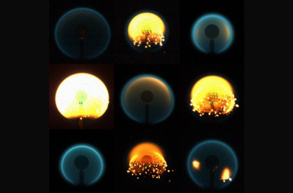

A composite of flame images from nine different tests of NASA’s Flame Design experiment, conducted in June and July 2019 on the International Space Station.
NASA

But in a microgravity environment, like the one astronauts experience while in orbit, all bets are off. Here, hot air still expands outward — but it doesn’t move upward, because there is no “upward.” Instead, fires in space are fed only by the random oxygen molecules that stumble into them by chance.
It’s a process called molecular diffusion, and it produces spherical flames that are different from their Earthly counterparts in more ways than one. Not only do they burn much slower and for longer periods of time, but they also survive on less oxygen and clock in at less than 900 degrees Fahrenheit — a fraction of the heat given off by most terrestrial flames.

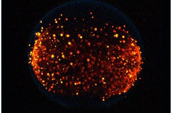

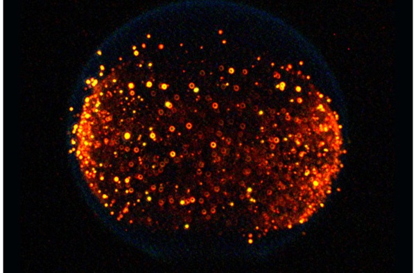

Flameignitioninspace
A flame ignited in microgravity as part of the ACME investigation. The yellow spots are soot clusters.
NASA
