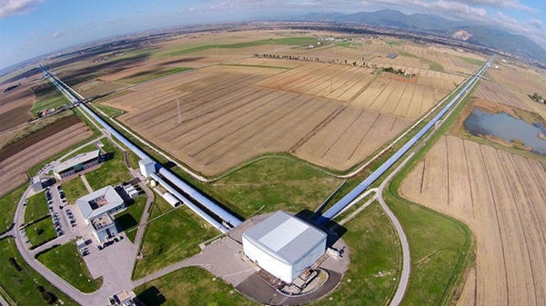

This is a view of the LIGO detector in Hanford, Washington.
LIGO Laboratory
