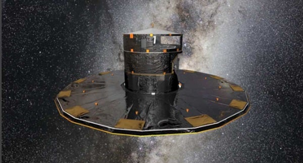

Gaia
ESA’s Gaia mission will produce an unprecedented 3-D map of our galaxy by mapping, with exquisite precision, the position and motion of a billion stars. The key to this is the billion-pixel camera at the heart of its dual telescope.

Gaia spins slowly once every six hours, sweeping its two telescopes across the sky and focusing the light from their separate fields simultaneously onto a single focal plane — the largest digital camera ever flown in space with nearly a billion pixels.

Another problem is associated with “stray light” reaching Gaia’s focal plane at a level higher than predicted before launch. This appears to be a mixture of light from the Sun finding its way past Gaia’s 10-meter-diameter sunshield and light from other astronomical objects, both making their way to the focal plane as a diffuse background.
