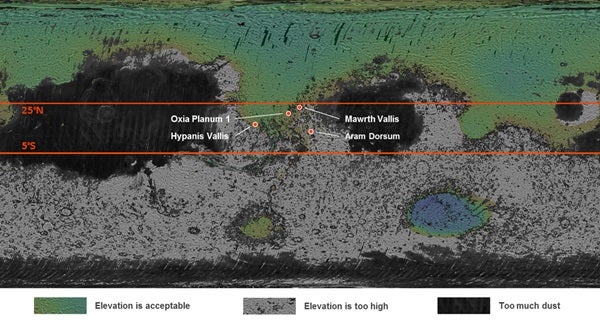

Four possible landing sites are being considered for the ExoMars mission in 2018. Its rover will search for evidence of martian life, past or present.

The sites — Mawrth Vallis, Oxia Planum, Hypanis Vallis, and Aram Dorsum — are all located relatively close to the martian equator.

“While all four sites are clearly interesting scientifically, they must also allow for the operational and engineering requirements for safe landing and roving on the surface,” said Jorge.
“Technical constraints are satisfied to different degrees in each of these locations and, although our preliminary evaluation indicates that Oxia Planum has fewer problems compared to the other sites, verification is still ongoing.”
The next stage of analysis will include simulations to predict the probability of landing success based on the entry profile, atmospheric and terrain properties at each of the candidate sites.
The aim is to complete the certification of at least one site by the second half of 2016, with a final decision on the landing site for the ExoMars 2018 rover to be taken sometime in 2017.
