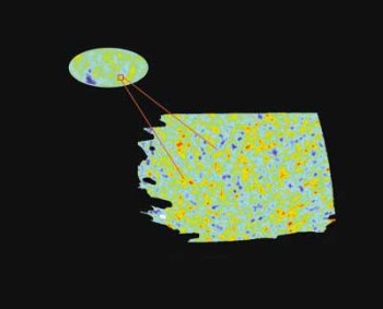

COBE data
Data from the COBE satellite (top) could only reveal hot and cold patches about 7° across.

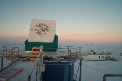

The Degree Angular Scale Interferometer
Located at the South Pole, DASI records slight temperature variations in the cosmic microwave background.

The BOOMERANG (Balloon Observations of Millimetric Extragalactic Radiation and Geophysics) experiment flew in a circle 120,000 feet (37 kilometers) above Antarctica from December 29, 1998, to January 9, 1999. An international collaboration, BOOMERANG created a map of the CMB at least 40 times more detailed than COBE’s, and witnessed harmonic-type peaks in the radiation predicted by inflation theory.

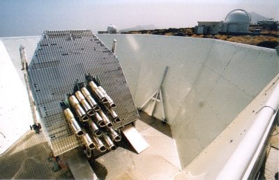

Very Small Array
The VSA uses 14 radio antennae to study the cosmic microwave background. The array is located about 7,900 feet (2,400 meters) above sea level at the Teide Observatory on Mount Teide in the Canary Islands.

The Degree Angular Scale Interferometer (DASI), a radio telescope composed of 13 connected detectors based near the South Pole, has been studying the CMB since late 1999. The National Science Foundation-funded telescope recently picked up extremely faint signals (less than one part per million) that the CMB is polarized. Most light is unpolarized, its waves arriving at our eyes and telescopes in a jumble of orientations. But when light bounces off a surface, its waves align in one plane. Since the CMB radiation last scattered from particles when the universe was 300,000 years old, theorists had predicted it would be polarized. Confirmation of this bolsters the big bang theory.
