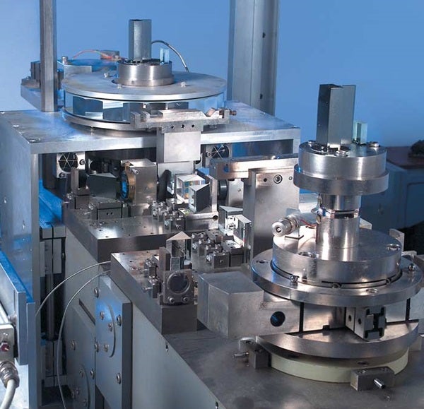

NIST designed and built this instrument to measure the wavelength, and therefore E, of gamma rays. The crystals are the dark gray rectangles on round platforms in the foreground and background.

Because the wavelength of electromagnetic radiation corresponds to a specific energy, NIST scientists measured the wavelength of gamma rays emitted by silicon and sulfur atoms to find E. As a nucleus captures a neutron, the nucleus releases gamma rays. Nearly perfect crystals were placed next to the gamma-ray source sources, so as each gamma ray passed through the crystals, its path was deflected. The NIST team then measured the tiny angles of the bend — on the order of 0.1 degree — and inferred the gamma ray’s wavelength.
