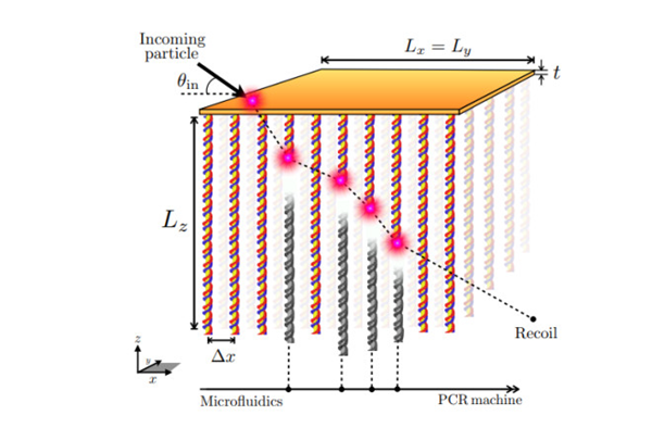

The new detector has a unique design based on DNA strands. It consists of a forest of double-stranded nuclei acids that hang from layers of gold metal sheeting. Each DNA strand is unique and its position within the detector known with nanometer resolution.
When a dark matter particle enters the detector, it slices through any DNA strands in its path, causing the broken segments to fall into a microfluidic collection system. “Since the sequences of base pairs in nucleic acid molecules can be precisely amplified and measured using polymerase chain reaction (PCR), the original spatial position of each broken strand inside the detector can be reconstructed with nanometer precision,” say the team. In this way, physicists can reconstruct the track of the dark matter particle through the machine.
