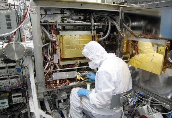

Sample Analysis at Mars (SAM)
A Sample Analysis at Mars (SAM) team member at NASA Goddard prepares the SAM testbed for an experiment. This test copy of the SAM suite of instruments is inside a chamber that, when closed, can model the pressure and temperature environment that SAM sees inside Curiosity on Mars.
NASA

The xenon experiment required months of careful testing at NASA’s Goddard Space Flight Center in Greenbelt, Maryland, using a close copy of the SAM instrument enclosed in a chamber that simulates the Mars environment. This testing was led by Goddard’s Charles Malespin, who developed and optimized the sequence of instructions for SAM to carry out on Mars.
“I’m gratified that we were able to successfully execute this run on Mars and demonstrate this new capability for Curiosity,” said Malespin.
