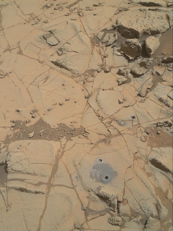

Gray cuttings from Curiosity’s drilling into a target called “Mohave 2” are visible surrounding the sample-collection hole in this January 31, 2015, image from the rover’s MAHLI camera. This site in the “Pahrump Hills” outcrop provided the mission’s second drilled sample of Mars’ Mount Sharp.

The rover used a new, low-percussion-level drilling technique to collect sample powder last week from a rock target called “Mojave 2.”

The drilling to collect Mojave 2 sample material might not have succeeded if the rover team had not recently expanded its options for operating the drill.
“This was our first use of low-percussion drilling on Mars, designed to reduce the energy we impart to the rock,” said John Michael Morookian from JPL, the team’s surface science and sampling activity lead for the Pahrump Hills campaign. “Curiosity’s drill is essentially a hammer and chisel, and this gives us a way not to hammer as hard.”
Extensive tests on Earth validated the technique after the team became concerned about fragility of some finely layered rocks near the base of Mount Sharp.
The rover’s drill has six percussion-level settings ranging nearly 20-fold in energy, from tapping gently to banging vigorously, all at 30 times per second. The drill monitors how rapidly or slowly it is penetrating the rock and autonomously adjusts its percussion level. At the four targets before Mojave 2, including three before Curiosity reached Mount Sharp, sample-collection drilling began at level four and used an algorithm that tended to remain at that level. The new algorithm starts at level one, then shifts to a higher level only if drilling progress is too slow. The Mojave 2 rock is so soft, the drill reached its full depth of about 2.6 inches (6.5 centimeters) in 10 minutes using just levels one and two of percussion energy.
