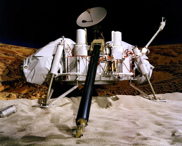

Viking 1 and 2 landers
The Viking 1 and 2 landers were twin crafts (a model of which is shown here) that each carried three identical biological experiments. The “Wolf trap” was not one of those, however, due to budget constraints.
