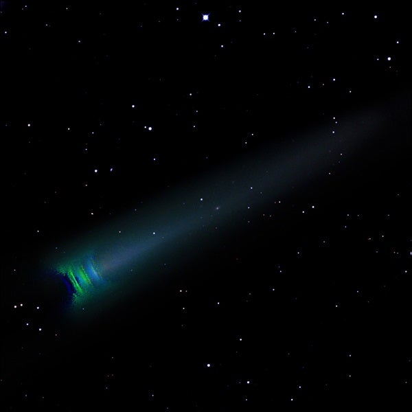

comet without starry background
To create this image, the author used a rejection technique common to image-processing software. It shows just the comet without the starry background. You can see a completed image at www.skycenter.arizona.edu/gallery/SolarSystems/ison_10082013.

Once you calibrate all of the exposures with darks and flats, you should register and combine the data set in two different ways. First, align the images using the stars. Before averaging the images, use a strong rejection algorithm, such as the “Poisson Rejection” feature in CCDStack. And here’s a tip: Standard processing requires that you normalize the data before you do any form of rejection. Programs vary as to how this is done, but you must do it to get the best results.
At this point, you’ll have an image with stars and a faded, mostly rejected comet. Then, with the same initial data, align on only the comet. This time when you combine the image using the algorithm, only the comet will remain and the stars will disappear. Even combining the data with the “Median” setting will work, but you’ll get a better signal-to-noise ratio using a more robust rejection technique that averages values after removing outliers.

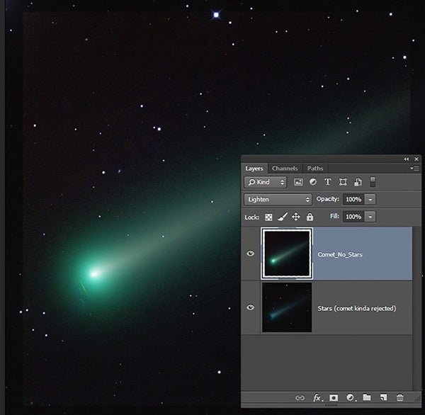

comet with screen shot
The author blended the two images above together using “Lighten” mode in Photoshop. In his technique, the layer with the comet overlays the one with the stars. The screen shot (inset) shows that he had not yet removed the comet entirely from the bottom image.
Once you create these two images, bring them into Photoshop as two layers and blend them together. Regarding the image of the star field with a faded comet, it is possible to remove or further fade the parts of the comet still visible.
Then, blend the layers using the “Lighten” blending mode. The comet layer (the one with no stars) will overlay on the star layer. Raise the black level and make the sky dark in the comet layer so the sky values don’t add to the image but only the comet is visible.
At this point, you should be close to the goal of a composite image. There may still be discontinuities between the two images. If so, often a simple mask with a strongly blurred edge on the comet layer will make artifacts nearly invisible.
