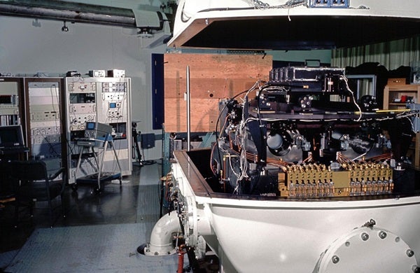

The enclosure for the Solar Fourier Transform Spectrometer, commonly called the FTS Tank, at the McMath-Pierce Solar Facility on Kitt Peak. The tank is shown open, with some of the equipment racks required to operate the FTS visible in the background. Credit: Tom Eglin, Mark Hanna/NOAO/AURA/NSF
