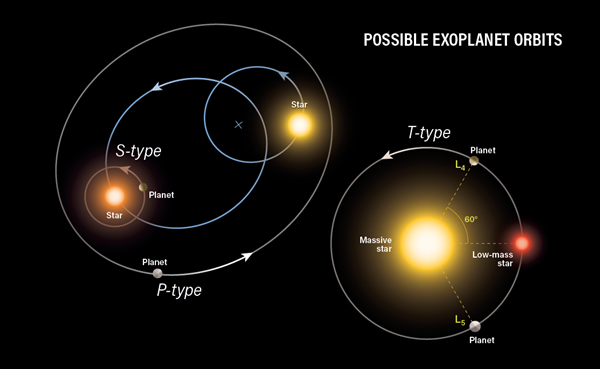

When binary stars are similar in mass (left), the two stars orbit the system’s center of mass (denoted here with an X). Planets in an S-type orbit circle just one star in the system, while planets in a P-type orbit revolve around both stars together. When one star far outweighs the other (right), the smaller star orbits the larger one. A planet in a T-type orbit would share the orbit of the smaller companion around the larger star, locked into one of two positions — the L4 or L5 Lagrangian points — ahead of or behind the smaller star.

A: Yes, planetary systems can exist in binary star systems. As of July 2019, astronomers have found 97 planetary systems containing 143 planets around binary stars. These planets may orbit just one of the stars in the binary system, called an S-type (satellite-type) orbit, or they can orbit both stars together from outside the binary, called a circumbinary or P-type (planet-type) orbit. Most of the known planets in binary systems have S-type orbits, in which they orbit close to one star and essentially ignore the companion star, which is farther away.
There is a third option, although no planets with this type of orbit have been found yet: a T-type orbit. In this configuration, one star in the pair is much smaller than the other. The smaller star orbits the larger star and the planet shares the orbit with the smaller star, gravitationally locked into a position either 60° ahead of or 60° behind the smaller star. These positions are called Lagrangian points. Planets in T-type orbits are sometimes called Trojan planets — just like the Trojan asteroids, for example, that share Jupiter’s orbit around the Sun.
