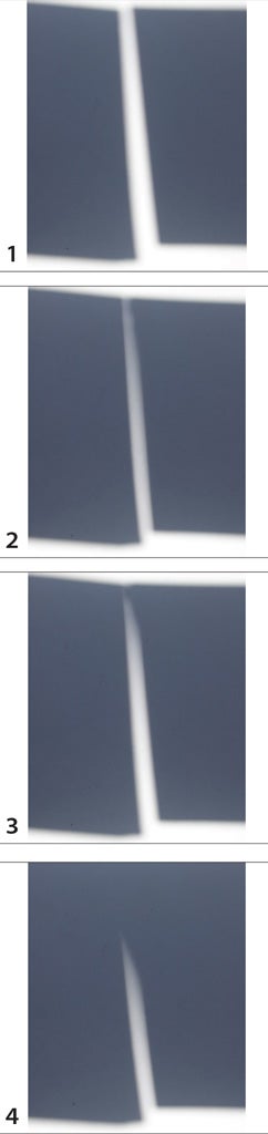

Take two books (one in each hand) into the sunlight. Standing upright, hold the books at arm’s length, making sure that their shadows appear well away from your own and fall onto a smooth surface like a wall or deck; for the most dramatic effect, the books should be at least 3 feet (1 meter) from the surface. Now bring the two books together until their shadows draw near each other. When you see a narrow gap between the shadows (Image #1), lift one of the books (say the right one) by about 6 to 8 inches (15 to 20 centimeters) (Image #2).
Finally, keeping the vertical offset between the books the same, move them so that their shadows draw closer to each other (Image #3). Watch carefully as the shadows inch closer. The shadow of the book that’s closest to the ground will be the one that appears to leap (Image #4). Reverse the position of the books, and you’ll see the opposite shadow reach out and “grab” the other.

The author used two books to create these images that show the optical effect “diffraction.” He describes the progression in the text.
Stephen James O’Meara
The basic principle at work is diffraction, or the property of light as it bends around edges to create an interference pattern of light and dark bands. The book closest to the surface creates the darkest and most pronounced diffraction pattern, so it becomes the dominant player.
As the light gap narrows between the books, the dominant one’s interference bands appear to move outward as an increasing number of dark bands become visible farther away from the dominant book shadow. As a result, the eye sees an unresolved mass of darkness appear to “move outward” from that book and all but leap toward the other (a grand optical illusion).
