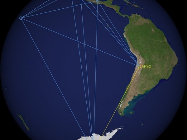

By combining telescopes across Earth, the Event Horizon Telescope will take the first detailed pictures of black holes.
The South Pole Telescope (SPT) and the Atacama Pathfinder Experiment (APEX) joined together in a “Very Long Baseline Interferometry” experiment for the first time in January 2015. The two telescopes together observed two sources — the black hole at the center of the Milky Way Galaxy, Sagittarius A*, and the black hole at the center of the nearby galaxy Centaurus A — and combined their signals to synthesize a telescope 4,300 miles (7,000 kilometers) across (yellow line). With this success, the SPT joins the Event Horizon Telescope array, which connects APEX, the Large Millimeter Telescope in Mexico, the Submillimeter Telescope in Arizona, the Combined Array for Research in Millimeter-wave Astronomy in California, the Submillimeter Array and James Clerk Maxwell Telescope in Hawaii, and the Institute for Radio Astronomy Millimetrique (IRAM) telescopes in Spain and France (not visible).
Dan Marrone/University of Arizona
