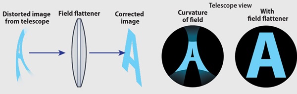

Curvature-of-field
Curvature of field causes corner objects to stretch out and point toward the center. Typically, the center will be sharp while the edges will appear out of focus. Astronomy: Roen Kelly
2You need a flat field. Curvature of field is a common optical defect in imaging. The optics of your telescope must include a field flattener to bring the stars into focus across the imaging device. Failure to do this will result in elongated stars in the corners, all pointing at the center of the image. You can test for this defect by moving the focus in and out to see if the edges become sharp at any point. If they do, and the center has become soft, you need to flatten the field.

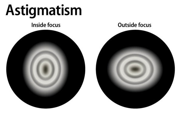

Astigmatism
Astigmatism results in oval stars that rotate 90° when observed on the inside and the outside of focus. Astronomy: Roen Kelly
4The worst affliction to have is astigmatism. This nasty situation primarily results from misalignment of the optics, so perhaps your optical setup only needs collimation to remove the defect. Many telescope owners are mortified to attempt this “tune-up” procedure, but it should be a prerequisite to owning a telescope. In fact, it’s really not your telescope until you can collimate it! How do you know that you have astigmatism? Slightly out-of-focus stars will appear as horizontal ovals on one side of focus, and as vertical ovals on the other.
