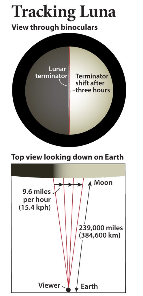

The Moon’s terminator appears to move about 8 arcseconds in an hour at its equator, which means it would take several hours before a viewer noticed new features using binoculars.

The lunar terminator, the sunset/sunrise line that sweeps across the Moon’s surface as the Moon orbits Earth, travels at a rate of 9.6 mph (15.4 km/h) along our satellite’s equator. Taking the average Earth-Moon distance to be 239,000 miles (384,600km), those miles translate to an angular shift of just over 8 arcseconds per hour.
So how much time would have to elapse before binoculars could detect a shift of about 8 arcseconds? The resolving ability of a telescope is dictated by aperture, assuming high-quality optics. The low magnification of binoculars, however, usually makes that value the determining criterion.
Assuming the observer has 20/20 vision, we can estimate the minimum resolution value for binoculars by dividing its magnification into 240. Using this, we find that 10x binoculars have a resolution threshold of 24 arcseconds, while 15x binoculars can resolve 16 arcseconds, and so on.
So, given all these facts and figures, steadily mounted 10x binoculars should be able to detect a shift in the terminator after about three hours.
