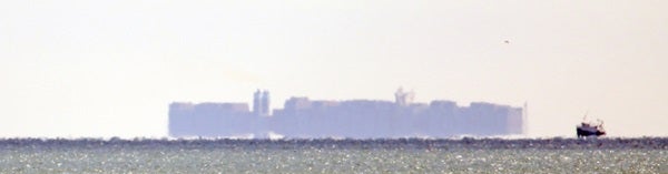

This inferior mirage over the English Channel shows an oil tanker with a conjoined mirror image of the ship’s tower, exaggerating its height. Note how the more distant front of the ship has all but vanished from view, leaving but a trace of the real ship floating on a mirror image of the sky below it.

In October 2016, I was in Eastbourne, England, experiencing unseasonably hot weather. Ships on the distant horizon appeared irrationally enormous while riding above the water’s surface on a cushion of air.
At first glance, it looked as though what I was observing was a classic inferior mirage. In this phenomenon, the ship seemed enormous because an upside-down image of the ship appeared conjoined and beneath the actual ship. Also, the “ships” appear separated from the horizon by a thin band of sky because some of the sky above the real ship is also part of the mirage in its mirror image.

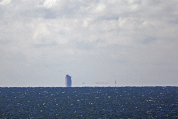

This inferior mirage over the English Channel shows a cargo ship with a conjoined mirror image of the ship and sky seemingly sailing above the sea. Note how the wave crests also seem to form miniature spires above the horizon line.
