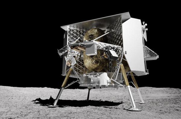

PYLDPS10scaled1
Astrobotic’s Peregrine lander will carry the solar-powered CubeRover onto the moon’s surface.
Photo courtesy of Astrobotic
