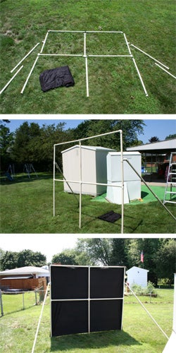

    Line-of-sight light intrusion is often more destructive than sky glow, so, once at your viewing site, choose a spot that will block as many sources of local light pollution as possible. Trees, buildings, and other obstructions often serve this role nicely.
    Chris Bayus device
    The only drawback to a cloaking device is that, in damp weather, it causes the eyepiece to fog.
    Chris Bayus
    But what if there are no conveniently placed barriers? In that case, some people bring their own along. Although he has since moved to darker skies in Grand Blanc, Michigan, Chris Bayus used to live in the city of Flint, where light pollution was a big concern. To combat the problem, he used a black terrycloth shield supported by a framework of inexpensive PVC piping. In calm weather, the shield was self-supporting, but in windy conditions, Chris staked the frame into the ground with U-bolts. An opaque black cloth was then attached to the frame using strategically placed Velcro pads sewn onto the cloth and glued onto the frame. The entire set-up took only a few minutes to slip together before each use.
