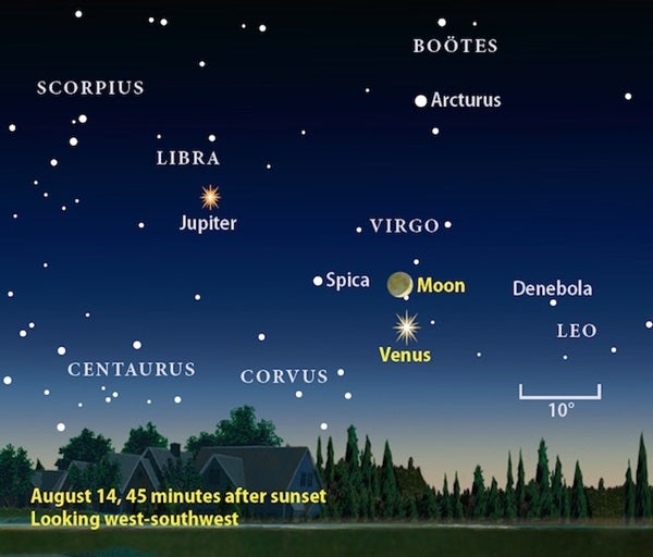

If you look west as twilight deepens, you can’t miss Venus. Earth’s neighbor brightens from magnitude –4.3 to –4.6 this month and appears prominent a half-hour after sunset. The planet moves eastward against the backdrop of Virgo, pulling closer to 1st-magnitude Spica. It approaches within 1.3° of this star at month’s end.
Northern Hemisphere observers won’t see Venus climb high. From 40° north latitude, the planet stands 10° above the western horizon an hour after sundown August 1. It appears 2° lower when the waxing crescent Moon passes by on the 13th and 14th. Luna appears 10° to Venus’ right on the 13th and 7° above the planet the following night.

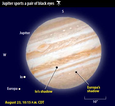

Dozens of such events occur in August, but perhaps the most appealing for North American observers happens on the 23rd. That evening finds both Io and Europa in front of Jupiter after darkness falls along the East Coast and during twilight across the Midwest. Io’s shadow first touches the jovian cloud tops at 10:02 p.m. EDT, 19 minutes before Europa itself moves off the planet’s western limb.
Europa’s shadow appears on the planet’s eastern limb starting at 10:34 p.m. EDT. For the next 97 minutes, both shadows transit Jupiter’s disk. (From eastern North America, the planet sets during the early part of this double shadow transit and prime viewing locations shift farther west.) Io moves off Jupiter’s limb at 9:59 p.m. CDT, while the shadows lift back into space between 9 and 10 p.m. PDT.

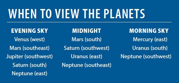

Whentoviewtheplanets

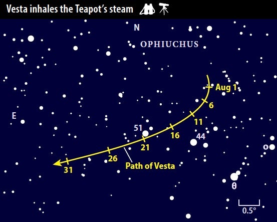

After viewing August’s four bright evening planets, how about a low-stress diversion? This is a great time to watch asteroid 4 Vesta shift from night to night as it crosses one of the emptiest zones near the Milky Way’s heart.
Whether you use binoculars or a telescope, this main belt object should be simple to find. With only a handful of nearby stars brighter than our target, the chart below will take the guesswork out of identifying 7th-magnitude Vesta from the distant suns.
The asteroid lies in southern Ophiuchus. To find it, zero in on this region’s brightest star, magnitude 3.3 Theta (θ) Ophiuchi. Then, shift your view northeast to where the chart shows you Vesta’s location. Alternatively, from a dark-sky site, you can jump to the spot on the southern flank of the star cloud dubbed the “Teapot’s steam.”
Like all solar system objects, Vesta changes position relative to the background stars as it orbits the Sun. But the asteroid’s motion this month is quite slow. Although its night-to-night movement is obvious, you’ll be hard-pressed to see it shift position during a two-hour observing session. Your best chance comes the evenings of August 20 and 21. Vesta then skims less than 10′ south of the 5th-magnitude star 51 Oph.
