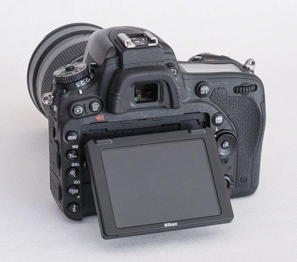

Ergonomically, the D750 has an articulating rear screen, so no straining your neck when shooting at the zenith. And the live view makes accurate focusing as easy as finding a star, enlarging it, and focusing it to a point. Another nice feature of the live view is that once you center a star at low power, it stays in view at higher powers, even though it might be located toward the edge of the frame.
The camera’s body is lightweight, with weather-sealed monocoque construction, carbon fiber-reinforced polymer in the front, and magnesium alloy for the top, sides, and back.
Most of the controls you’ll need to take great images are on the back of the camera. The vari-angle LCD screen makes viewing it easy no matter where the camera points.

Above the “ISO” button is the “QUAL” button. Holding it down while scrolling with the rear wheel allows you to choose the quality of image setting. Choose “Raw” if you process your images. To see at a glance what all your settings are, press the “Info” button below the back wheel.
Note that the left-hand buttons have dual functions depending on the mode you’re using. For example, in live view mode, which you’ll use for focusing, “QUAL” will switch automatically to the “Zoom in” button. It’s marked with a “+.” The “ISO” button becomes the “Zoom out” button. It’s marked with a “–.”
When you turn on live view, you’ll see a square. Put your focus star into the middle of the square by using the directional dial under the “Info” button. Once centered, it will stay there as you zoom in to inspect the focus. Exit live view by pushing the “Info” button once more.
