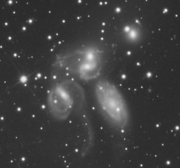

Stephan's Quintet
In the author’s original image of Stephan’s Quintet (NGC 7317, NGC 7318a, NGC 7318b, NGC 7319, and NGC 7320), the galaxies show little detail.

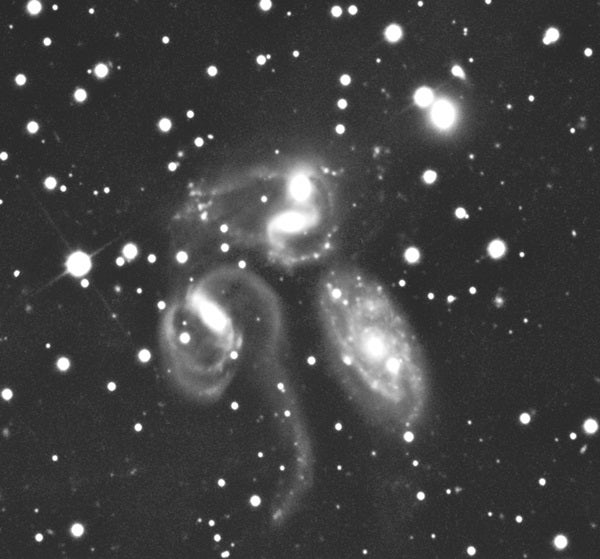

Stephan Quintet
When the author processed the image to increase the contrast in the galaxies, the stars (and the galaxy cores) became intolerably bright.

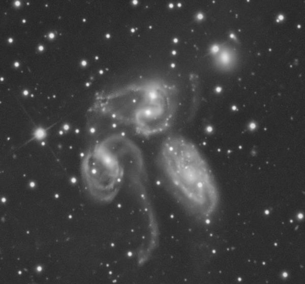

Stephan's Quintet
By using the process outlined in this column, the author was able to increase the detail visible in the galaxies and keep the star images small.
