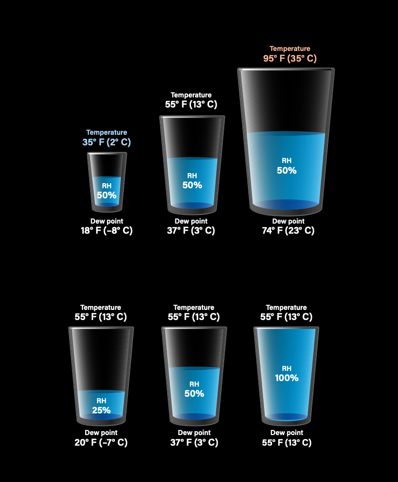

The atmosphere can only hold a finite amount of water before it becomes full, or saturated. That amount is somewhat flexible (it is possible to be oversaturated), but that definition is good for our purpose here. The problem is that the amount of water a sample of air can hold depends on temperature.
Relative humidity (RH) is a comparison between the actual amount of water in the atmosphere and how much would be needed to saturate it. If you have 80 percent RH, then the air is holding 80 percent of the water that it could — at that temperature. It’s kind of like a bucket that’s 80 percent full at one temperature, except that the bucket would grow larger as the temperature goes up and shrink when it falls. The amount of water wouldn’t change.
Dew point is the temperature at which the moisture in the air would condense and, supposedly, form dew (or frost) on a telescope. To belabor our example, it’s the point at which falling temperatures would shrink our bucket to the point where the contents overflowed. In practice, dew point is a more stable measurement of water in the atmosphere. It measures the absolute amount of water rather than the relative amount of water.
For example, a sample of air that is saturated at 40 degrees Fahrenheit (4 degrees Celsius) and one that is saturated at 78 F (26 C) both have a relative humidity of 100 percent, but the sample at the higher temperature has 3½ times as much water as the colder sample. Both are filled when saturated, but one contains much more water.
Now consider the dew point: Let’s say both samples are in same-sized buckets and have a dew point of 32 F (0 C). That’s a relative humidity of 73 percent for the cooler sample and 23 percent for the warmer. Both will reach condensation at the same temperature. And, at 32 F (0 C), air has a “moisture content” of 0.09 pound per square inch (0.006 kilogram per square centimeter), or 6.11 millibars. Those look like strange numbers, but that’s because moisture content is usually expressed as vapor pressure — the pressure that the water molecules contribute to the total atmospheric pressure. The units don’t matter; what matters is that the number is the same for both samples. In other words, they both have the same amount of water vapor, and if our two buckets were cooled to very cold temperatures, they would have the same amount of ice on the bottom.
