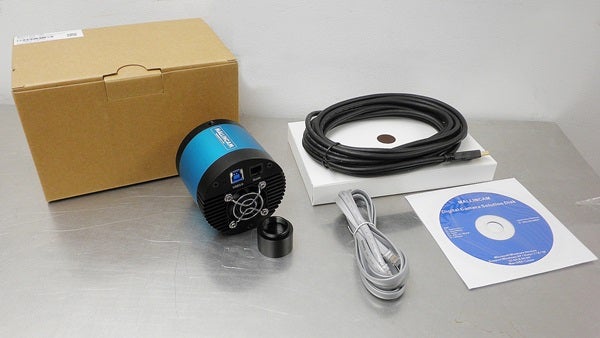

When I received it, the camera arrived in a sturdy cardboard box. The package included a rubber dust cap, a 1¼” nosepiece, a 15-foot-long (4.6 meters) USB cable, a 10-foot-long (3m) ST-4 guider cable, and an installation disk.
The DS2.3 Plus is a 2.3-megapixel one-shot color camera containing a Sony IMX302 Exmor CMOS sensor. The sensor measures 13.4mm diagonally and has pixel dimensions of 5.86 x 5.86 micrometers. Potential exposure times range from 25 microseconds to just over 16 minutes with a maximum frame rate of 30 per second.
The camera body measures 80mm wide and 85mm long, and has an integrated fan-cooled heat sink to regulate its temperature. The camera has a standard T-mount interface but also comes with a C-mount adapter. The camera body with its C-mount adapter weighs just under 1 pound (430 grams).
The machining and finishing of the all-metal casing is of high quality, and the little details — such as a sealed sensor chamber, a robust USB 3.0 B-type connector, and a whisper-quiet cooling fan — combine to make a top-notch product.

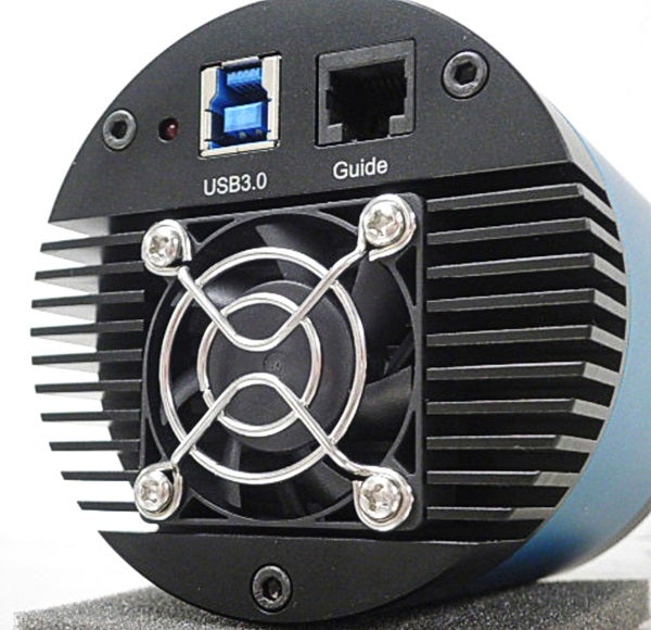

This close-up view of the camera’s back panel shows the cooling fan and cable connections.

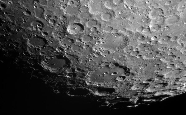

The author captured the Tycho-Clavius region of Moon on April 16, 2016, by connecting the DS2.3 Plus to his 10-inch Ritchey-Chrétien reflector at f/20, using a Baader Moon & Skyglow filter and taking a 20-millisecond exposure.

Mallincam doesn’t market the DS2.3 Plus as a solar system imager, but I decided to try it in that role nonetheless. First up was the Moon. I had some concerns that the moderately sized sensor pixels of the DS2.3 Plus would hurt its ability to capture fine detail and that I’d need more magnification. Typically that means longer exposure times, which in turn allows more atmospheric distortion.
In the end, I found that the high sensitivity of the IMX302 sensor allowed for generally low exposure times. This sensitivity extends well into the infrared, allowing for the use of an IR pass filter to further improve the image quality.

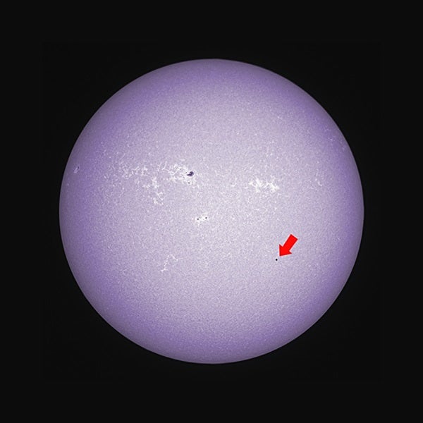

The author imaged Mercury (arrow) transiting the Sun on May 9, 2016. He used a William Optics FLT98 refractor at f/6.3, an Omega Optical CaK filter, and took a 4-millisecond exposure.
J. Thompson
I then aimed it toward visible planets. On the first evening, I had a look at Jupiter with the IR pass filter. Imaging Jupiter in IR can reveal details in cloud features that you cannot discern visually. Later on, I imaged Jupiter again, but in the visual band, along with Mars and Saturn. Saturn was near the horizon, so I’m surprised I got a useful image. My image of Mars, however, is probably the best I have ever captured from my location in Ottawa, Canada.
Finally, I observed the Sun with the DS2.3 Plus. I used it with white-light, Calcium-K, and Hydrogen-alpha filters. I also had a rare opportunity to use the DS2.3 Plus to observe the May 9, 2016, Mercury transit from the lawn in front of the Canadian Parliament buildings. It was quite an experience sharing my live view of the event with the public and a number of dignitaries, including retired Canadian astronaut Marc Garneau. In all cases, I found the camera worked well for solar imaging, again due to its high sensitivity, which allows short exposure times.
