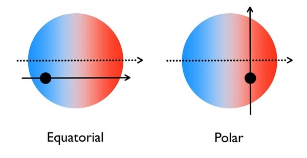

asd2
As a star rotates (indicated by the dotted arrow), different portions of it appear to be moving toward or away from us. The light coming from the side of the star that is moving toward us appears bluer. The light coming from the other side, moving away from us, appears redder. A planet traveling across a star’s disk occults (blocks out) different parts of the rotating star, giving away the direction and location of the planet’s orbit.
Sarah Brands
“A star is not a point source, it is a big object, and it rotates by itself,” explains Vincent Bourrier, a research and teaching fellow at the University of Geneva and lead author of the new study. The light coming from the side of the star that is moving towards us appears bluer, and the light coming from the side moving away from us appears redder. A planet gives away its orbital motion when it passes in front of the star’s surface, occulting (or blocking) parts of the star that move at different velocities.

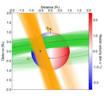

Now, the new paper has pushed this technique to its limits to determine the orbital motion of the innermost planet (b), which is to date the smallest planet to be studied in this way. The result was surprising: HD 3167b’s orbit is nearly perpendicular to that of HD 3167c.
asd3
This model shows the orbits of two planets around the star HD 3167. The inner planet, HD 3167b (green), travels in a somewhat tilted orbit compared to the star’s equator, and the outer planet’s orbit, HD 3167c (orange), is almost perpendicular to that of the inner planet.
Vincent Bourrier
